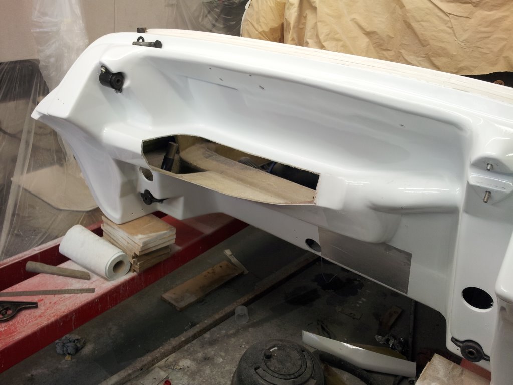

I have got my tank all done I hope I have made it correct thanks for the plan peter.
There were two problems, why you need a new tank the clutch slave cylinder on the PG1 bracket and also the cylinder head water outlet hoses.
hits the main tub so peter made another fuel tank to fit behind the seats he cut out quite a bit to clear the engine which rendered the fuel tank space compromised.
I hope I have made it the same shape as the one peter made for his car

Post Re: Paul's k3
Yep, that looks good to me.

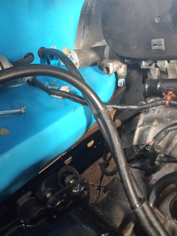

still doing the wiring I have put two relays with fuse holders in the front of the car this seemed to be a good place for two relays and fuses
as the battery and fans are in the front and I can connect the high power side of the relays directly to the battery
I'm going to have two fans in my car
One relay is for the radiator fan which is controlled by the mems3 ecu. ( the blue-gray wire ) which runs from the back of the car
from the mgf loom and runs fan number one
fan number two will run from the metro temp sensor which is in the radiator you can just see it in the photo this has no relay just as it was in the metro
and relay number two is for the fan that the mgf has in the engine I had to run a wire back to the engine bay as the fan is in the back with the engine I do not have a fan in my engine bay but I will have all the wires in the car if I want to add one.
the fan will come on if the engine bay gets too hot this is controlled with an engine bay temp sensor

I have started to put my new petrol tank in the car
I seem to be taking more of my car apart than putting it back together it looks like I have got the engine and subframe back on the main tub but it is just sitting on some axle stands
I still need to cut the main tub :lol:

Great work, is the tub cut for the tank or the clutch, how many gallons can you get in the tank??

by my calculations the tank should hold just shy of ten gallons. I hate having to fill up every five minutes!!
