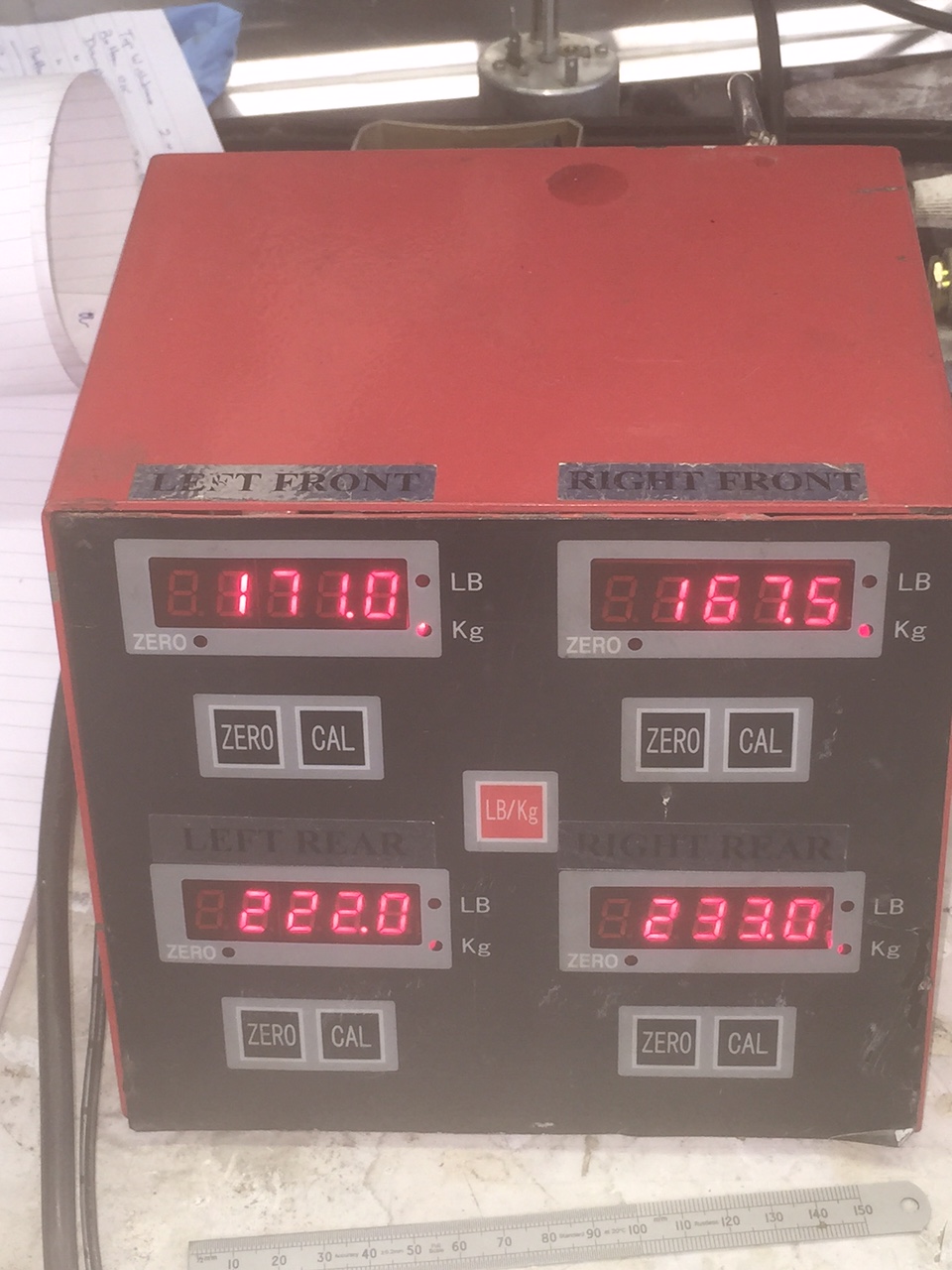

Damned annoyed at not being able to get the K3 to Stoneleigh. I need a couple more weeks cos work gets in the way!
Managed to get the suspension up and set, I have gone for 200lbs front springs and 300lbs rear as a starting point with adjustable dampers to add stiffness when needed.
Corner weighting took all day but satisfied with results, 4 kgs front and 11kgs rear with my weight included.
Just the really annoying bits to finish off before MOT.
