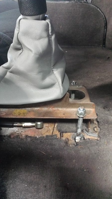

Paul.
When you installed the VVC engine and box, did you use the MGF gear cables and shifter, and if so, did you need to modify anything and/or cut off the shifter balance weight?
J.
Fri May 18, 2018 2:16 pm
Post Re: Paul's k3
hi I did you use the MGF gear cables and shifter, all I did to my one was put some threaded rod in the 4 holes in the corners
I did cut off the shifter balance weight?
works ok in my car you just need to check there are two different cable setups on the gearbox end the Gearbox Gear Selector Linkage Brackets I think
