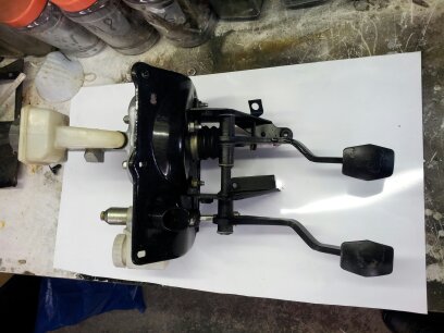

catsam
Joined: Thu Jun 27, 2013 11:32 pm Posts: 501 Location: Norfolk GTM: Libra
 Re: Brake Upgrade for K3
I have got a Rover Metro pedal box to play with you can see how much the k3 pedal was shortened I hope I got this right Peter i need to move the pivot Point and cut the pedal to 185mm
