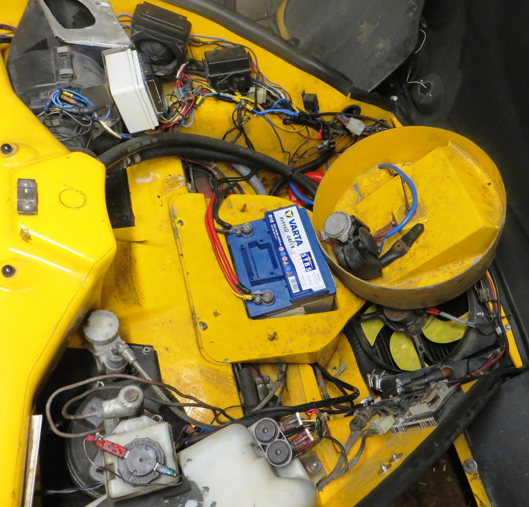

Anyone got a photo of the battery clamp on a Libra? I have two studs (one either side of the battery) and a missing clamp, which looks as though it should straddle the battery terminals! Shocking!

The two studs stuck up either side on the battery box are for the spare wheel (FG) moulding which covers the battery and holds the spare wheel in place.
Sound like yours is missing, it's quite a big part so not like it can really hide anywhere.
There is a long stud in the middle you can put a bar/nut on to secure the wheel.
I have my horn mounted inside it.

Ah, yes I do have one of those, it was hiding in the garage! I knew it was for the spare wheel/tyre, but didn't realise it held the battery in place as well.

FYI the studs are m6 and not stainless, I use wingnuts n waxoyl.
