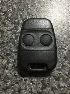

Does the car have central locking? Does the fob look like this?
On mine I have 5AS and that fob but don't use it and leave the system disarmed all the time as I have a separate alarm/immobiliser/door locking system.

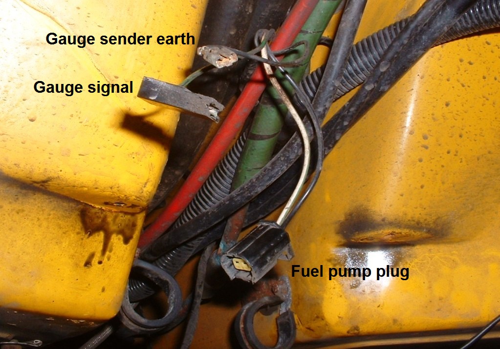

If you can i'd find the fuel pump feed at the relay and connect straight to 12v and see if it runs - at least you will eliminate it and save having to drop tank to find out. Or there might be a plug at the back end of the tunnel (under car in front of tank) coming off the main tunnel loom which is the fuel pump connection.

Hi, thanks for your advice sidewinder, I'll get underneath and trace the wires. Swapped in a good battery and the engine cranks over quickly but no fuel from the line I removed from the rail.
Yes, it's the same keyfob and does seem to be operating now... but only when the key is in and ignition is on! :?: so won't open or close the doors remotely from outside the car! :)

You should hear the pump prime when switching ignition on, if it's working normally.
FYI The 5AS immobiliser kills the fuel pump feed if it's 'armed'.
