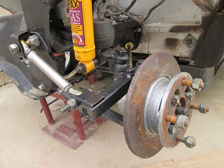

Hi Harold,
I made arms to replace the Mini steering arms and left and right hand M12 threaded links with spherical bearings and a nut with a shank to fit onto the upper arm spindle, the same idea as the Rossa Parts steering locking system.
I'll be back in the UK on 18th April and they could be posted to you if still needed.
I'll take a picture of the steering lock and post it, Its too hot (45c) whoooo outside just now

Post Re: Rear wheels
It is a straight bolt on apart from having to drill 2 extra holes in the subframe for the support bracket on the inner pivot, just a thought are you using 13" wheels? as they would not fit inside a 10" wheels, that is why the Mini steering arms are such a funny shape :lol:
