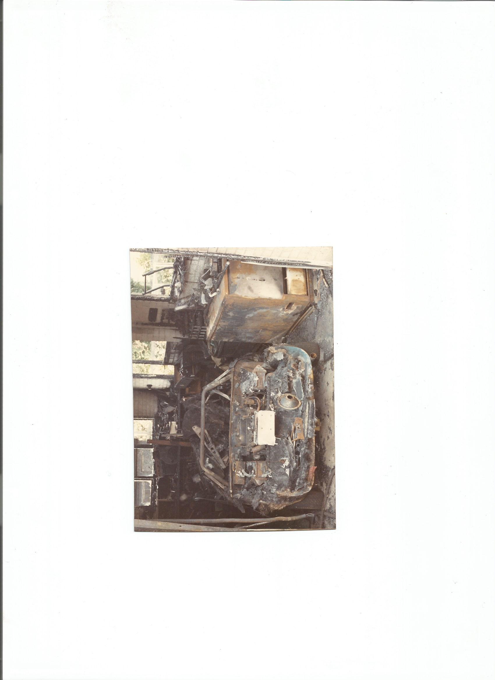

Some body on here will recommend a company making tie rods with right and left hand threaded ends, I have to make my own here at the ends of the earth and am just sorting out a new rear stear locking system to fix to the lower arm and caliper back plate (could be Plan F) anyway think posative everthing I have heated has come loose :mrgreen: dont burn the car, I lost my 1st Cox GTM in a garage fire :oops:

Don't worry I got the hint, that was a very sad day :oops: I will dig out and post pictures after the fire :cry:

Cremated GTML 129 1969 Cox GTM all Copper S engine and brakes 1426cc on 45 Webber
Fri Mar 18, 2016 7:24 am
Post Re: Rear wheels
The world was almost upside down that day
Fri Mar 18, 2016 7:26 am
Holy smokes, what a sad day
Fri Mar 18, 2016 7:51 am
That looks like quite a project. How is the rebuild going? :wink:
Fri Mar 18, 2016 8:20 am
The fire was in 1989, very slowly :roll:
