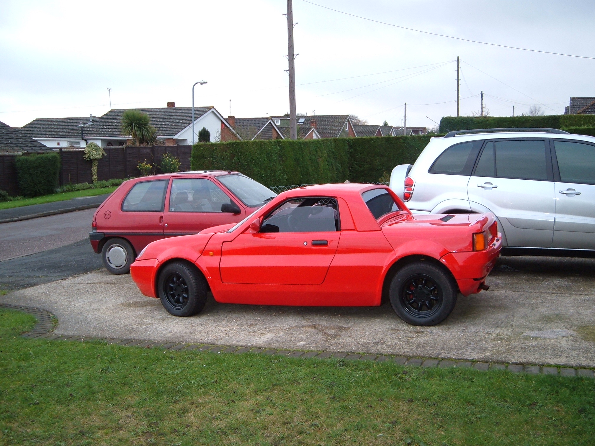

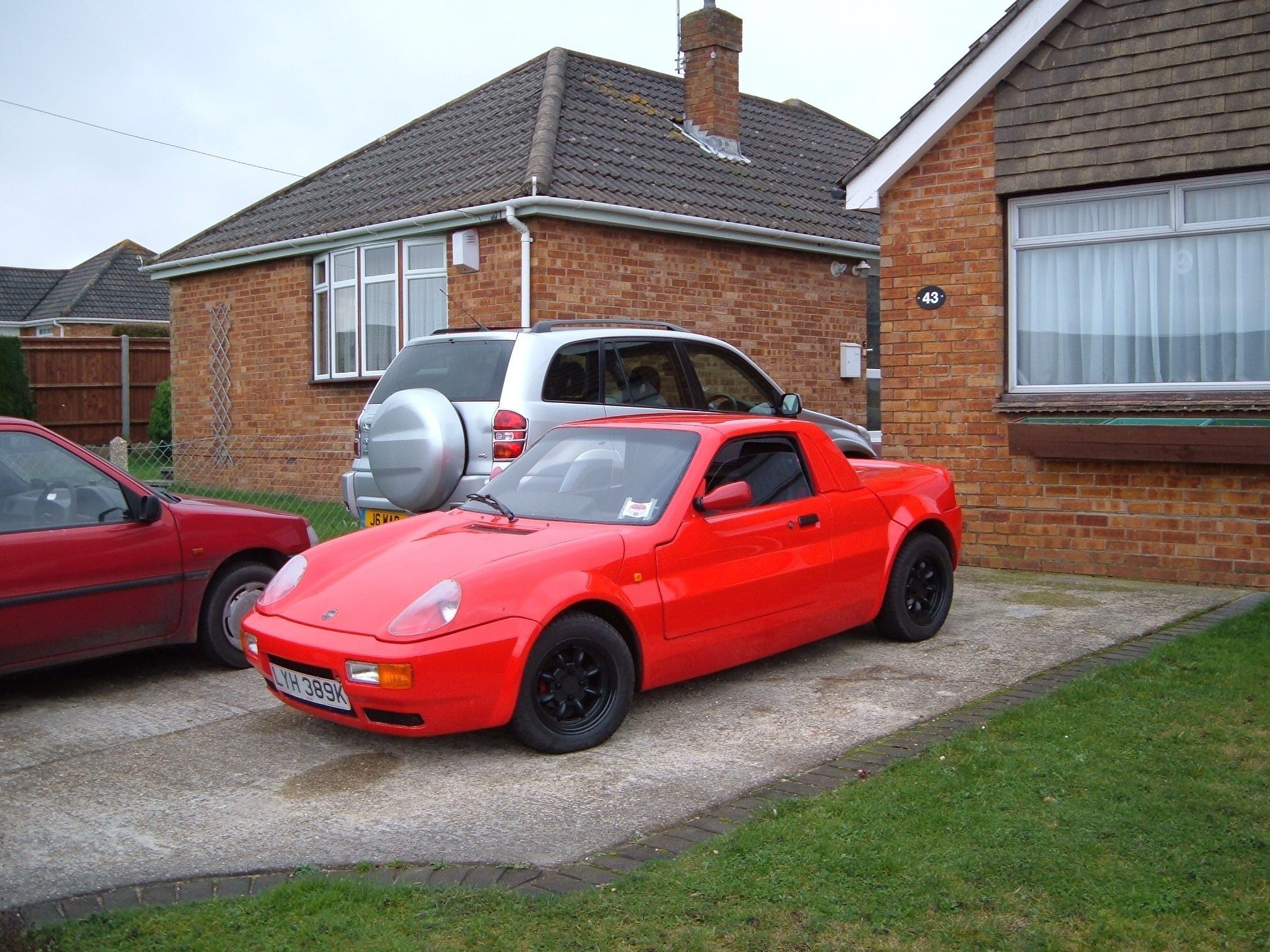

Well, winning ebay bidder was spanish and wanted to run some con which involved the seller organising shipping.
Seller phoned me, I've seen it, it's pukka and I've bought it for less than my highest ebay bid - can't be bad :mrgreen:
