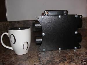

Now stripped out the dash and mini heater. Replacing heater (4 KG) with one weighing 1.2KG.
!BdtJbIgBWk~$(KGrHqUH-D8ErGWvg!9(BK6HF8SEjg~~_35[1].jpg [ 9.31 KiB | Viewed 10815 times ]
Also have an Acewell digidash to fit, so should save more weight.
Total weight saving so far 30.5 KG
