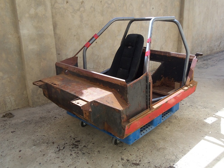

I got all the bits out of the Box on Saturday afternoon and then put all the body work plastic back inside, as all the initial work will be to build up the chassis until it is a rolling chassis.
I had prepared a pallet with castor wheels to put under the chassis for ease of movement during the oncoming work, next was the start of the cleanup of 30 or more years of neglect and storage in damp places, I had been told by the seller colin47, when I bought it off him that he had bought it from a chap in Wales who never got round to building it, now for the curios part, after Saturday afternoon and Sunday morning scraping and wire brushing, it is obvious that the chassis has had a body attached, traces of fiber glass on the tube door pillars, witness marks where bits have been bolted or riveted on, but the body that came with it was not drilled for fixing points behind the doors and no signs of being bonded onto the door pillar tubes, very strange.
With my old Cox Gtm all the work was mechanical, replacing engine, gearbox and brakes, apart from cutting intakes and air outlets for the radiator, oil-cooler and cool air for the carbs I never had to work on the chassis or body and only when you see a bare chassis do you realize just how many bits go into making it, I’m sure there is plenty of scope for simplifying and lightening it.
One of the differences between the Cox and later Coupes is the early cars having a deep vee formed in the chassis at the base of the screen whereas the later cars are flat; on the Cox this was an ideal place to put the petrol tank, well away from the potential accident when located inside the front subframe and with the spare wheel standing in front of the tank as an extra cushion leaving plenty of room for the front mounted radiator and its outlet ducting, so this is another mod on the list, I have to make a tank so why not modify the chassis to fit it in.
I shall be taking bits in to work to make, or modify for a long time to come, first is to make the floor stiffener plates to go under the cage legs so that the cage can be welded into position.

Hi Sven,
I did take a couple of shots yesterday after removing 30 years + of barnacles and rust and positioned the P&P cages roll cage into rough position,
I tried to post, but the file size was too big and I have not worked out how to reduce them :oops: any advice welcome.

Work in progress

I hope it's true I heard there is somebody here in Kano who can sandblast bigger items, in the south of the country the boat yards would be able to do it, 1200Km from the sea not many boats up here, camels don't like to be sandblasted :roll:

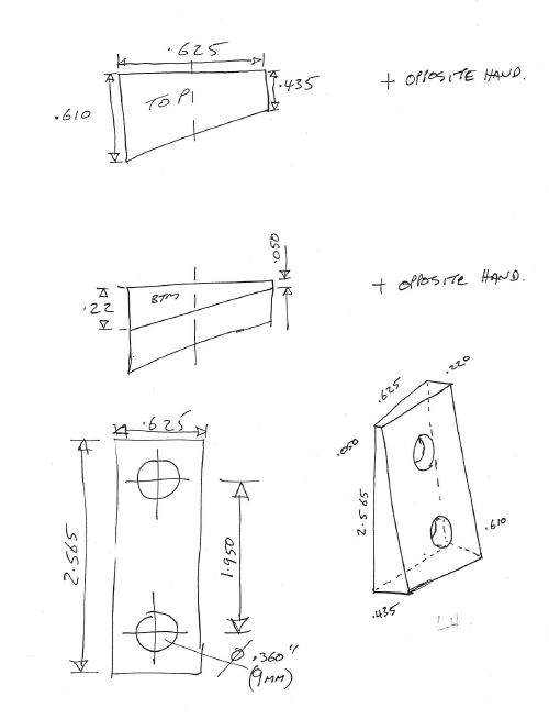

Just found my 1st snag as I was looking what holes I have to make for rack and peddles, the rack mounts on my donor car are on the body, the subframes that came with the GTM have the mounts on the subframe, but there must be a saddle under the rack where the U bolts pass into the subframe, anybody have a pair of saddles and U bolts they would like to sell me, or can make a dimensioned drawing so that I can make them?
Next problem the holes for master cylinders and accelerator peddle are very poorly done, just the thing our local bush mechanics could do!! I’m not sure I can trust taking measurements off the old holes and transposing them to the other side of the chassis, has anybody got proper measurements of the peddle position and steering column holes.

Here is a sketch of the blocks which fit on the rear face of the front subframe for the steering rack mounts.
