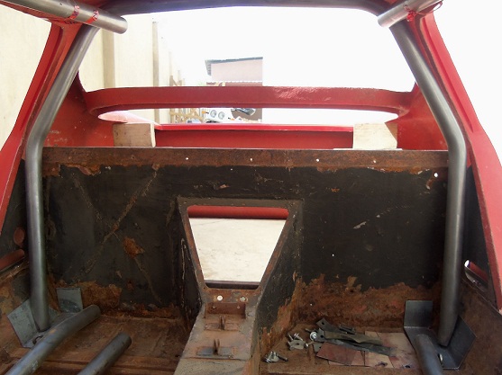

Drilled and fitted the rear body, to be able to cut the main roll cage hoop tubes to length, next job to make cage pipe clamps to get the front stays and top of the screen tube into position before tack welding, every time I look I see more thing to do :lol: and working in a little heat trap is very dehydrating, I have to put tools in the shade or they get too hot to pick up, I never had this problem working on a bike undercover inside.

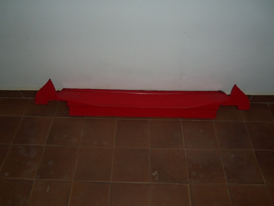

I'm sure I've left myself open to some silly replies :lol: but any suggestions where I should put this bit? I thought below the rear window but have another bit that goes in there and attaches to the rear bulkhead.

Think I worked the mystery piece out, fits to the rearmost part of the subframe mount and bonds into the top of the rear wings :oops: I never had one of those in my old Cox :roll:

John,
You're right -- that piece is the extension to the boot bulkhead -- on a road car it allows the boot to be sealed off from the engine compartment and made "watertight" -- some people don't fit it as it restricts the space for the air cleaner.

Yes that piece goes between the engine and luggage compartment. Any water that drips through the joint in the engine/boot cover drops onto that and is directed forwards to fall down behind the engine.
