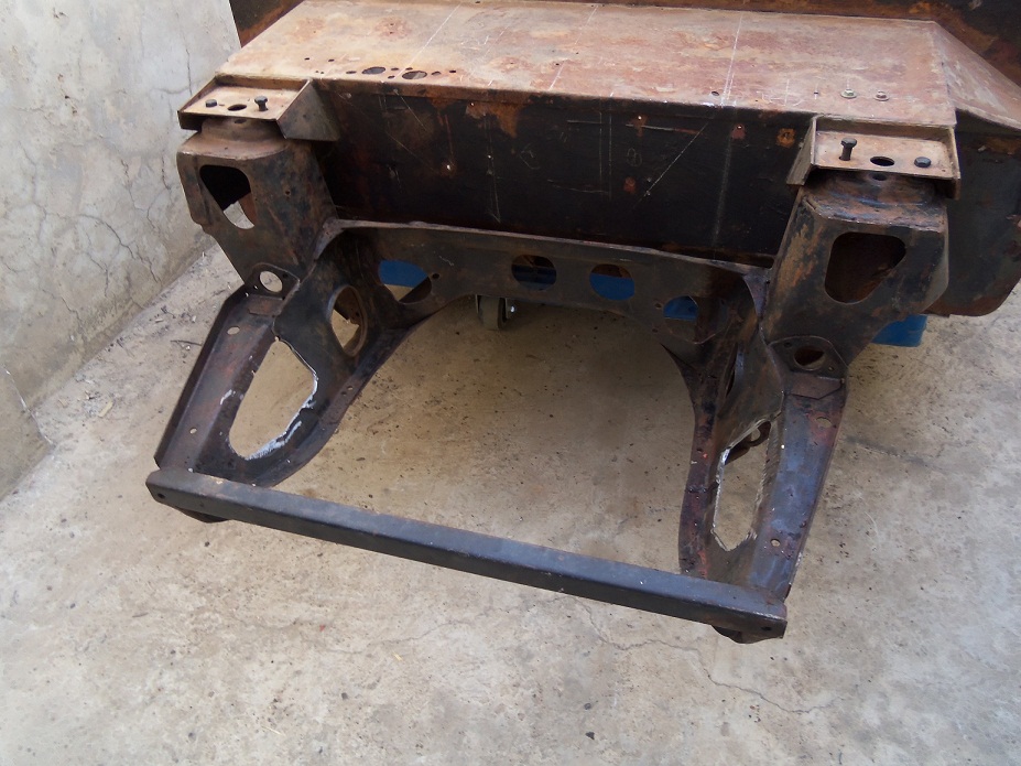

I cut holes into the front sub-frame to lighten it, unfortunately the rear sub-frame that came with the car looks to be a gonner, it has been used with top and bottom arms loose on one side and the inner pivot holes are elongated, no problem I have the rear sub-frame in the twinny
Anybody have a spare spacer that goes between the cone spring top mount and the chassis, I need to know the thickness so I can make some, every time I look at it I see something more to find or make :roll:

Anybody out there knows the thickness of the spacer between the subframe top mount above the cone spring and the chassis, I think about 1/4" but have not seen one in about 15 years and don't like to guess :oops: an easy job but I have to make them.

You're right they're 1/4" thick -- made of 2 parts -- a thicker section that is 3/16" that has larger holes to allow the raised sections on the subframe to seat and a 1/16" top plate with smaller holes clearance size of the mounting bolts -- the third central hole allows access for the spring compressor.

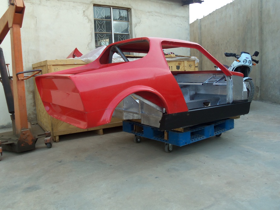

I just got my chassis back from the sandblaster and leaning against a tree so a gofor can paint red oxide primer on its underneath, thisafternoon it will be turned over to do T'other side :D

Looking much better now :D mext is to bond in the boot and buy a a box of pop rivets to attach body to chassis

That is looking very tidy! You make progress so quickly thus you are very annoying :lol:
What's the bike lurking back there? is it an Aprilia?

Progress will slow down when I have to find bits that I don't have, I cant carry everything back when I return from the UK, I'm trying not to strip out everything from the twinny donor, so looking for a R-H rack, a R-H upper suspension arm, I have 2 L-H :( gear lever/selector, I will probably make.
The bike is a Gilera RC600 one of 3 Gilera's I have, I only know of another Gilera in Zimbabwe, more than 20 years old was a barn find covered in straw and chicken sh*t that I bought for spares then changed my mind and rebuilt it :D
