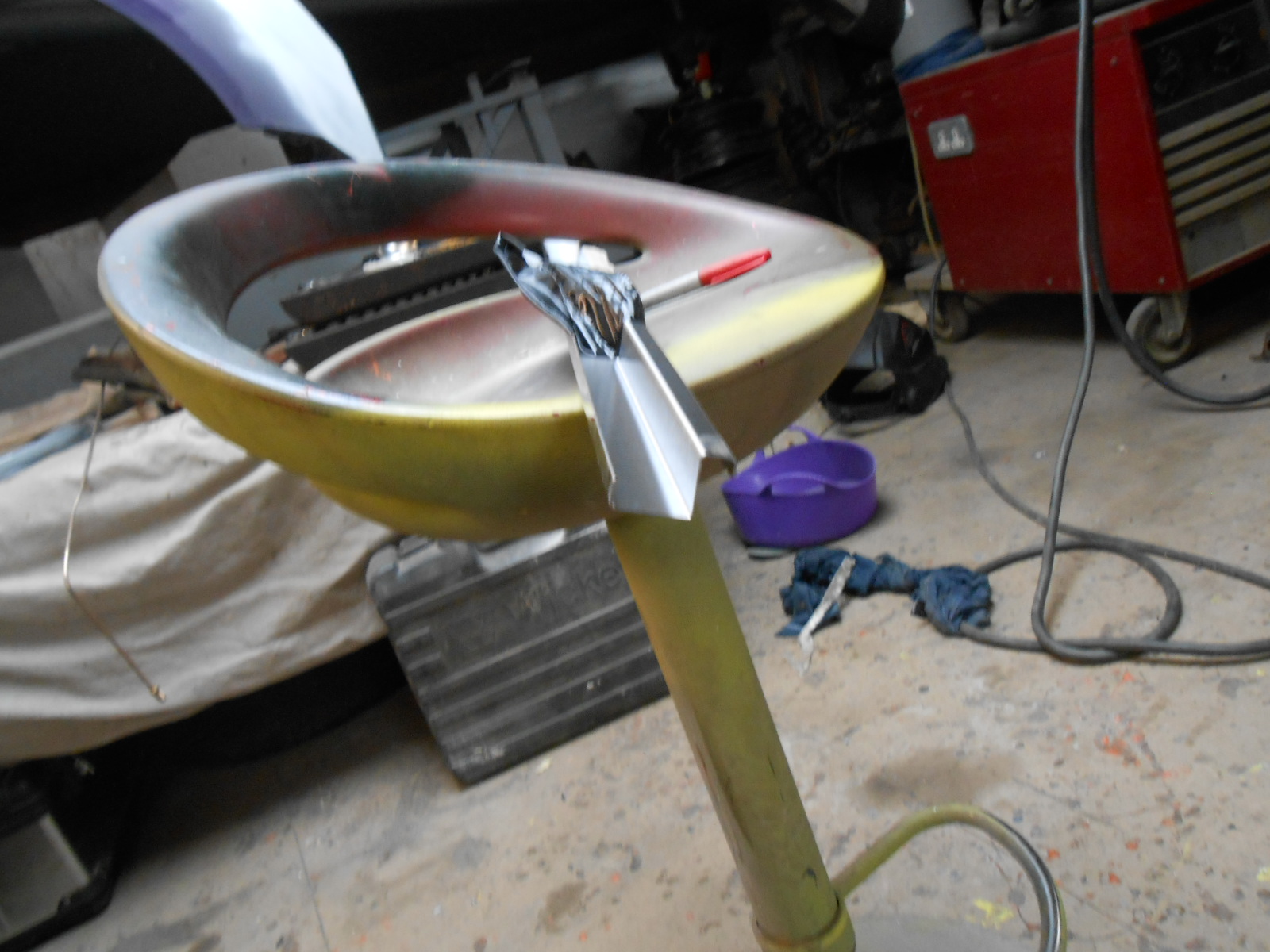

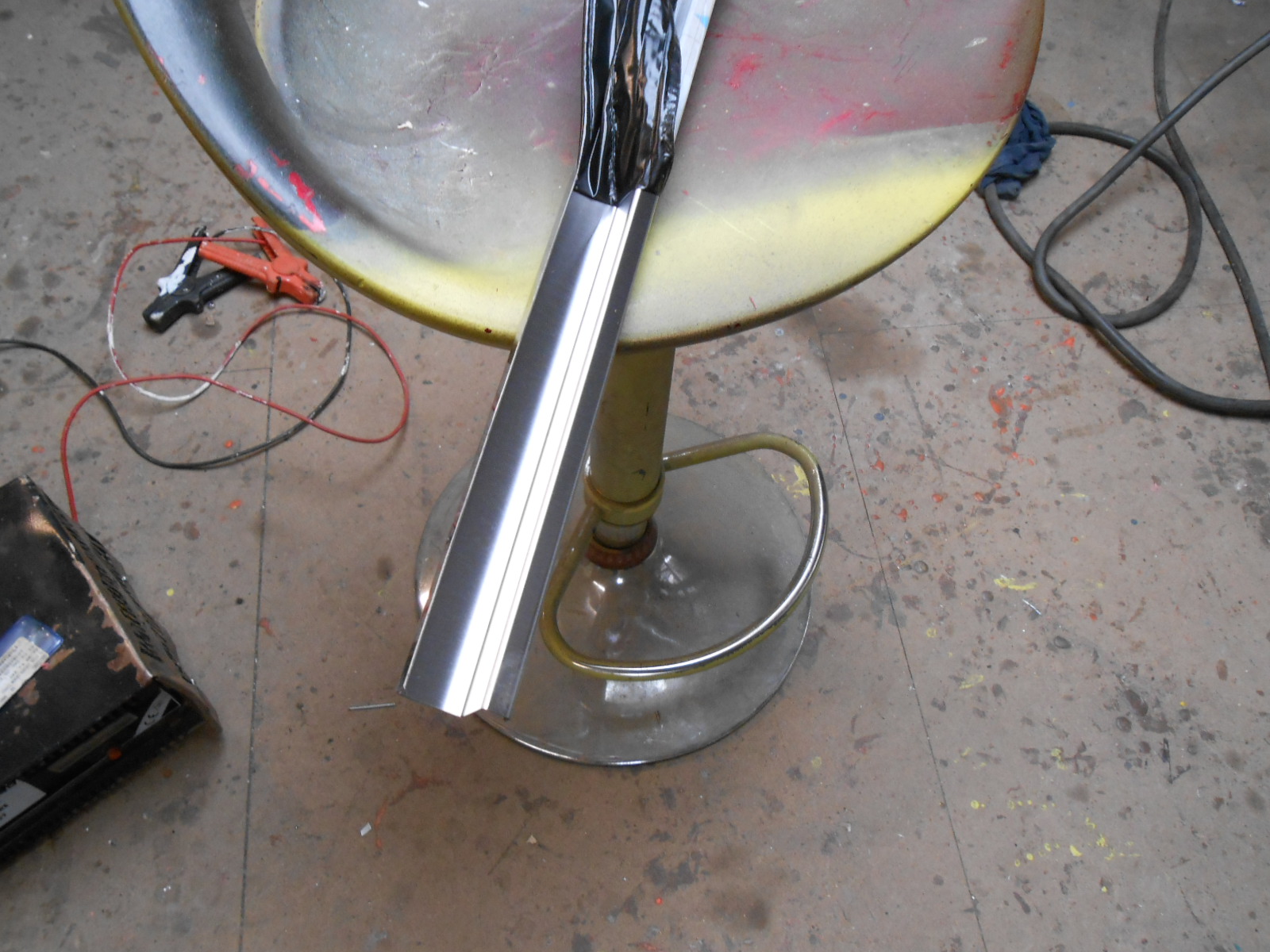

Hi there,
I have a batch of undrilled window channels in satin finish stainless steel.
Derek Hambly
