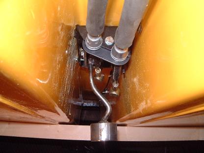

I am converting from metro gearbox to MGF PG1 gearbox with cable change to replace the rod hopefully?I am after infomation regarding doing this conversion I have a mgf gearchange assembly, can I use this if so how or do I need to get the change from GTM.

The counter weight needs to be cut off and the lever bracket heavily modded to fit in the tunnel. GTM make a smaller one so it fits in the tunnel.
I wouldn't use the MGF gearchange. At least one person I know has ditched the MGF in favour of the Elise set up. They found the MGF to be as bad as the rattle rods!
If you are prepared to throw some money at it then Mike Satur does a Billet mech that works well. Dave Boud has used that in his VHPD Libra

Hi, If you have the metro box it should have a lever and a large bob weight on the top, if it is a PG1 box it will have brackets on the rear face. One cable goes over the top of the gearbox and clips onto the top bracket and the other cable goes underneath the engine and locates in the bottom bracket. MGF cables just push on to the ball joints on the levers.

I think the answer is No. The Metro box linkages are significantly different, and operate above the box, whereas the PG1 is actuated from below. If you have an MGF sourced PG1, then it should/may have the requisite brackets to anchor the cables, but if you have an ex-ZR, R25 or VI box, then it won't, and you will need to get hold of the correct MGF abutments, or fabricate your own. GTM used to supply the appropriate parts, together with the cradle to fit the cut-down MGF selector. The cradle is pretty simple, being, largely, a box with no top or bottom - the selector mechanism fits neatly inside the "box", then the box is secured to the tunnel. Of course, my own experience relates to the Libra, but the principle is the same for the K3, though from memory the tunnel in the K3 is shallower. You will have to modify the MGF cables - in the Libra they have to be lengthened, in the K3.......??

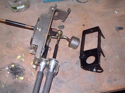

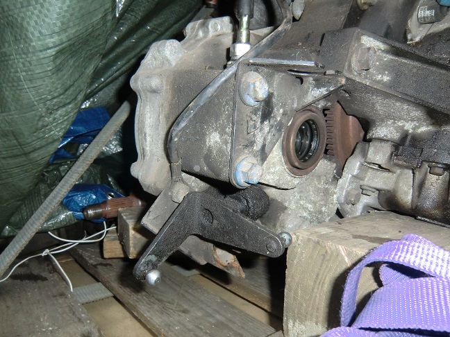

I'd like to get a look at the at bracket as well. I'm going to convert my newly acquired Libra from rods to cable and the previous owner wasobviously thinking of doing the same, the car came with the brackets shown below:
Not sure if the black gearbox brackets are rover or GTM? The gearshift housing looks like a std MGF with the front cut off? I'd love to see a picture of how the bracket needs to be modified to fit the libra tunnel (presume the k3 would be similar). From what I've read here the short cable needs lengthening as well or can you just use two long cables?
Be watching this with interest as I can't live with the gearchange quality at the moment.

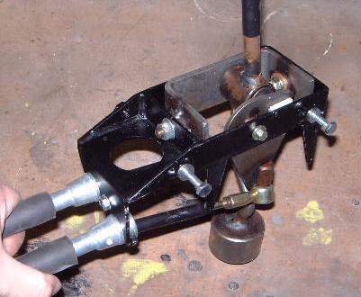

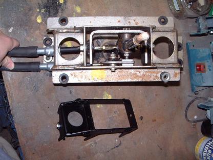

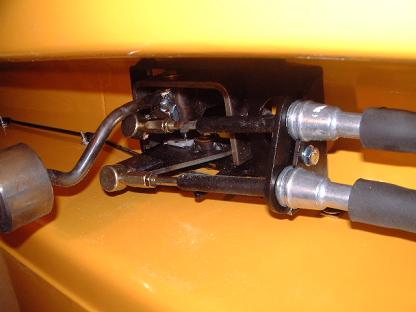

Here you go. These might help. I can't remember where I found these but they are on the net somewhere. The last two show the GTM supplied cradle next to the MGF one.
Not sure how wide the tunnel is on the K3 but to fit the tunnel on a Libra/Spyder the side flanges of the MGF bracket need to be cut off. I also cut off the front set of cable mounts as you only need the back ones. If you need to lengthen the cables then you can extend the cable outer mountings back using the "front" ones you cut off fixed further back. I used the side flanges as a bit of now spare steel to weld the bracket further back and extended the inners with bits of M6 threaded rod and stud connectors. I've got a photo on my camera showing what I made (but my camera is in the car in my MiL's garage right now).
The other problem is how much stuff there already is in the tunnel. the yellow one in these pics is fitting the cable change bracket first so nothing in the way! On mine the pipes and wires are fitted high to avoid the rod change but I need to move these all downwards to get the bracket in. All the pipes and wires are P clipped with bolts through the side of the tunnel so I've had to strip back the carpet and underlay to get to the bolts. Some are very hard to get to!!

Oh yeah, The bob weight does need to be cut off as is would hit every speed hump! I think it is only there to help self centering and to give the lever some momentum to help the changes. Some people use springs on the mech to help the self centering.
On the GTM bracket the MGF innards are transfered over so what you end up with isn't much different to a cut down MGF anyway.

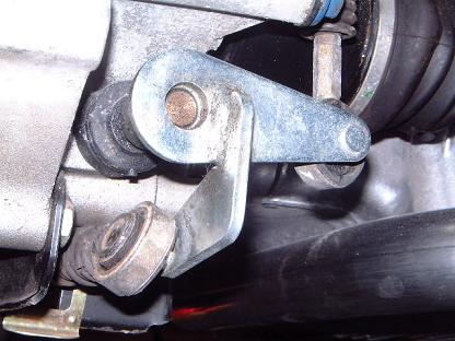

MGTF Style gearbox end bracket
MGF Style gearbox end bracket

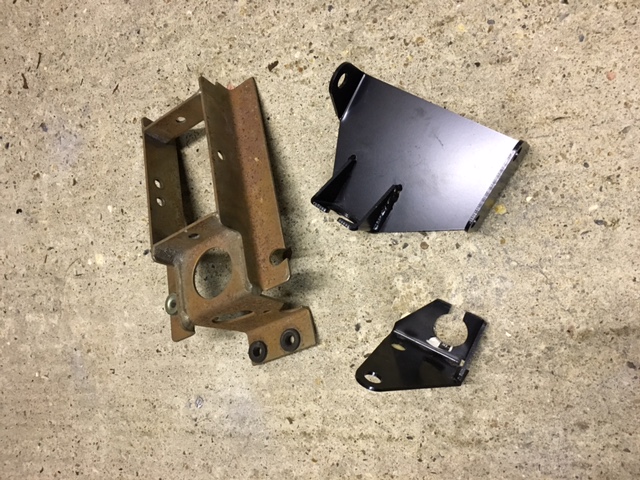

Hello jaykart 1227
The parts you have in the picture are ones I sold to the last owner a few years ago. The black parts are gtm made parts to hold the outer cables at the gearbox end the cut off rusty part was to cut down to make the gtm size part for the gear lever that gtm would no longer supply .I sold them because the because my car has a Honda 1.6 engine so they won't fit my car. I had cut a bit off the mgf bracket to modify my gtm part to make it work with 2 long cables I have pictures but not any help with your engine/gearbox
