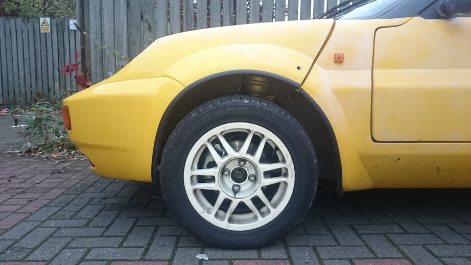

Been getting a little bit of wheel rub on my front clam shell at high lock, it's always done it but with the current parking arrangements at my house it's particularly bad as need to slalom my way in.
From the picture, it looks like it's dropped but the mounting point only has 2-3mm play, which rules that out. Tempted to make another plate with a lower hole (to raise the front of the clam) to see if that helps but wondered if anyone has any experience with this and if there is a better way as there doesn't seem to be much more movement so will likely need to move the pivot point.
Thanks! :D

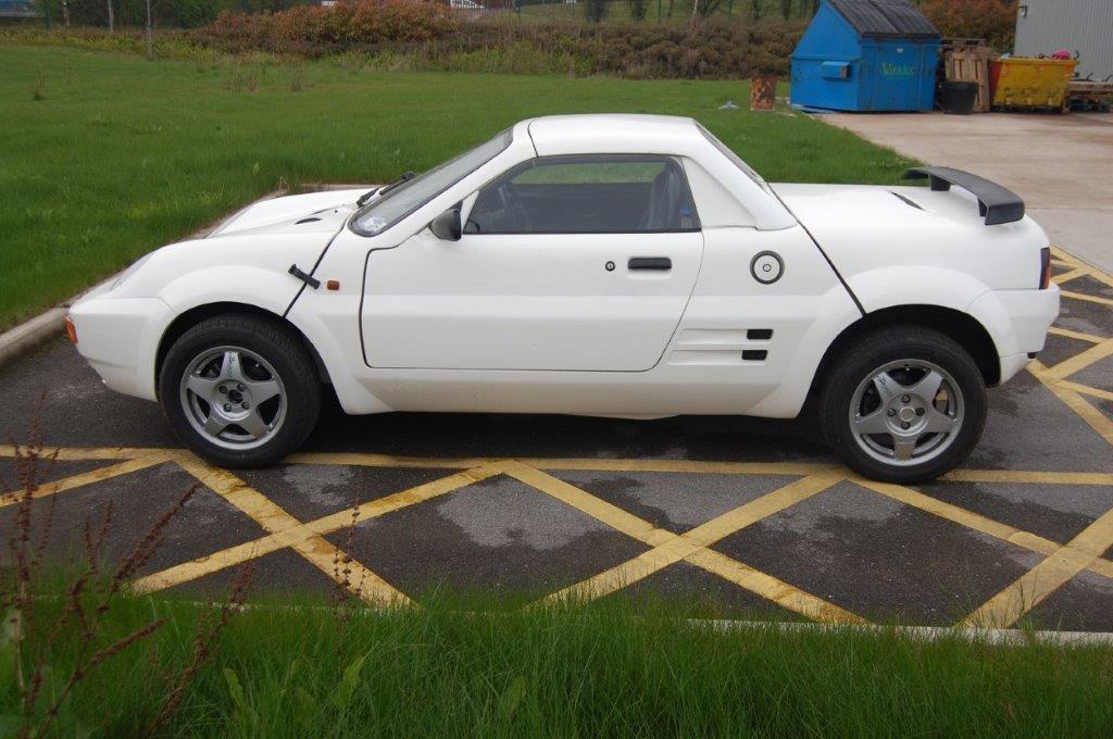

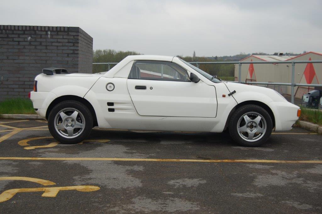

Thought so. Looking at the original pictures of my K3 with the metro supframe as you can see near side very close, offside fairly middle.
I will measure up the car and mounting points just to be awkward, I dont think there is any room to move the subframe back on the near side but I will have a think.
