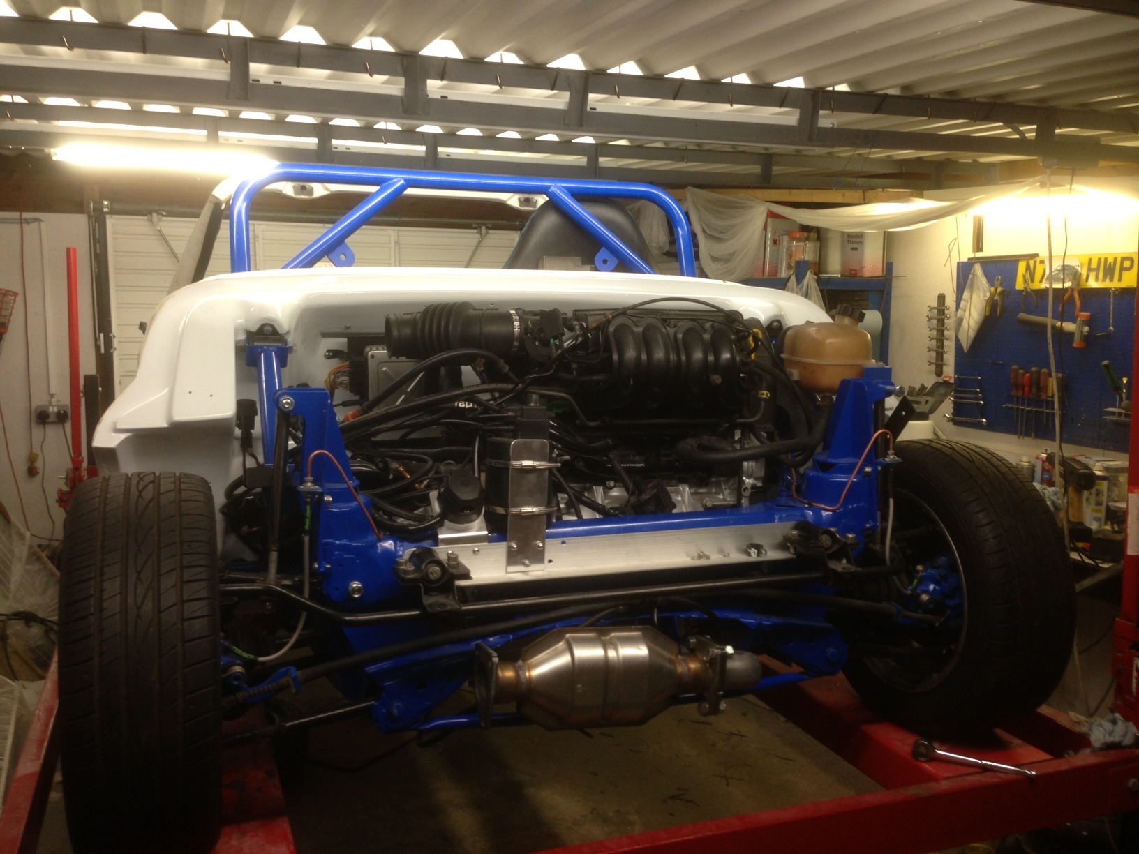

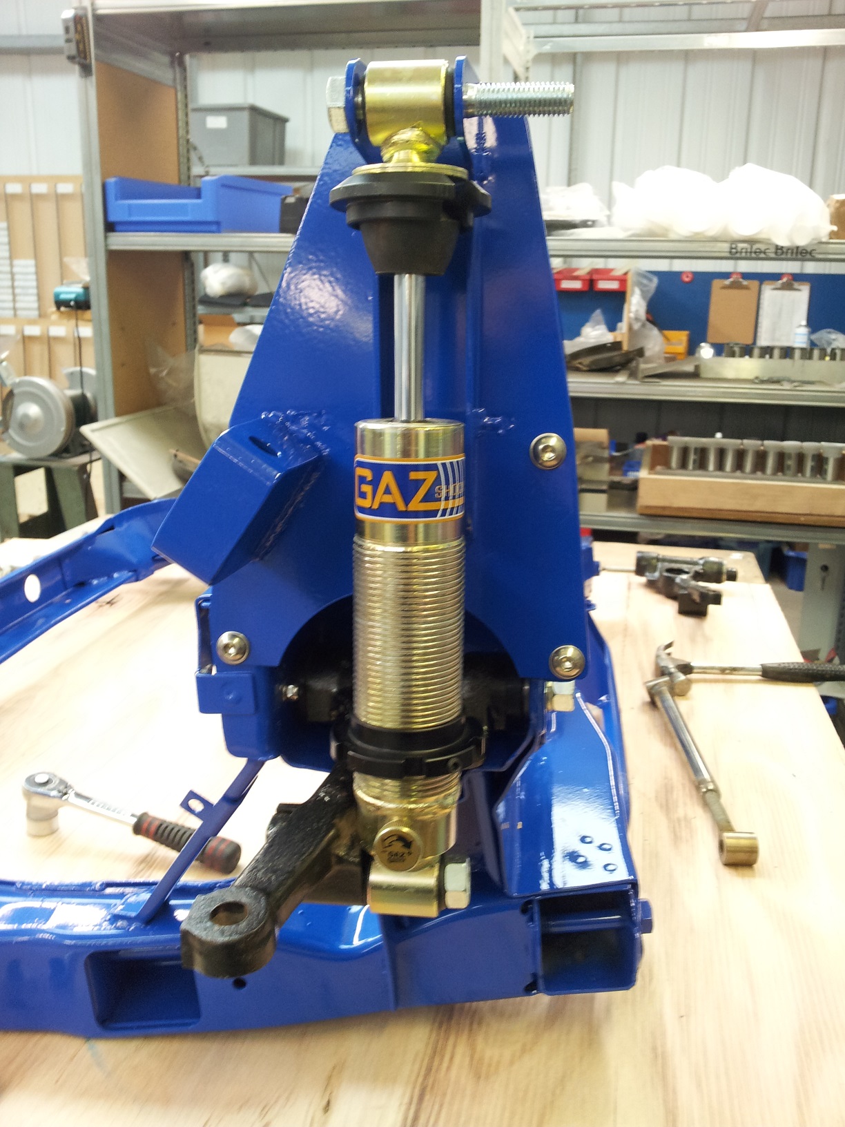

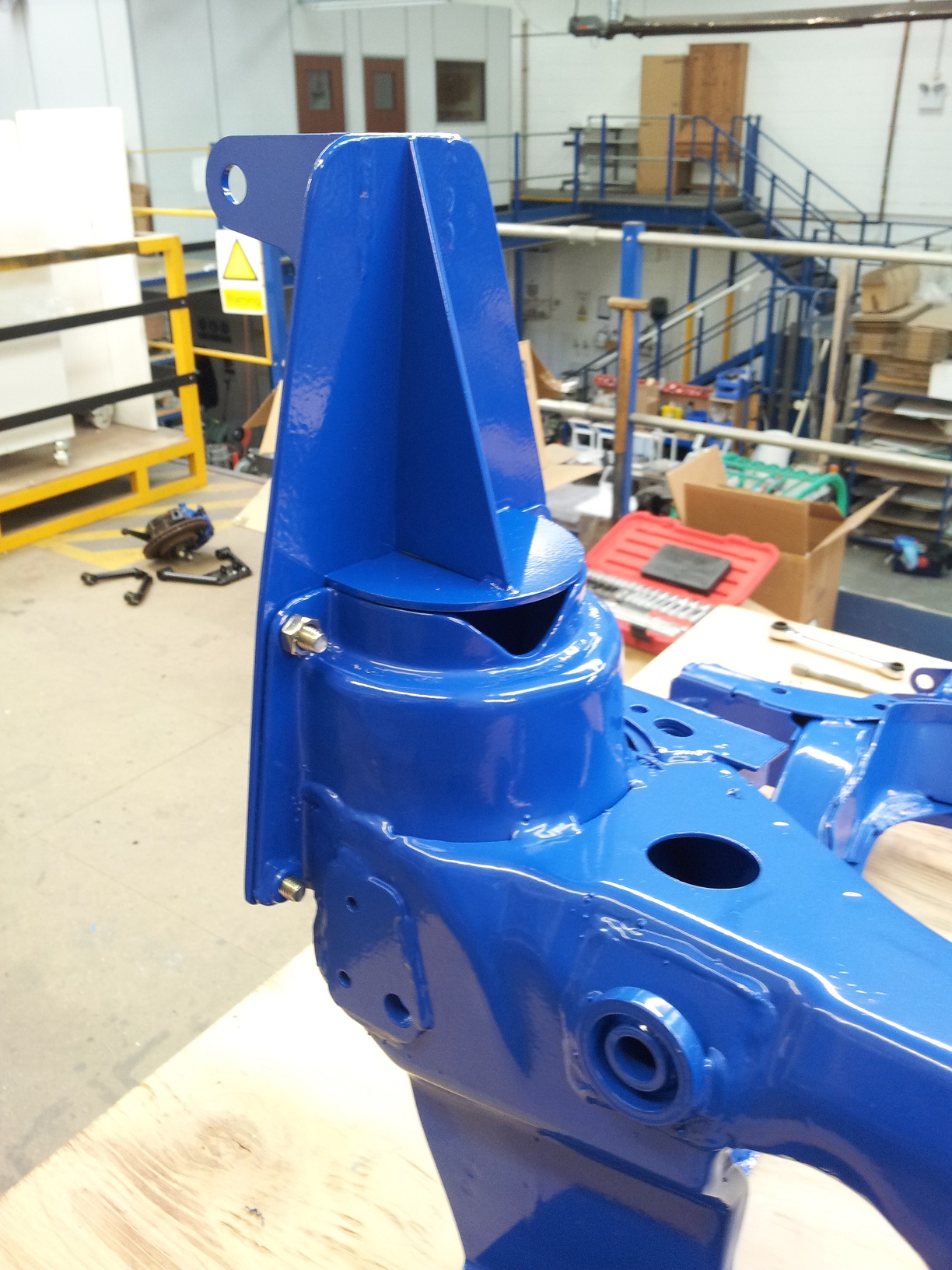

Hi Oliver, Had to post on here as I had problems with the pm. As you can see from the pictures the bracket does go higher than the sphere but not by much. The triangular brace piece is 137mm high + the 3mm thickness of the plate gives 140mm above the subframe sphere holder. because the bracket is fairly narrow you shouldn't have to butcher the heater vent too much. On a separate note I have some spare spheres which you are welcome to (off the K3 and MGF) if you need them. Peter.

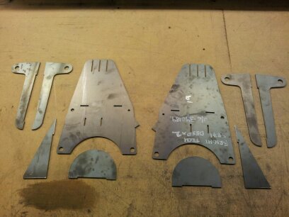

Comes as a kit of parts that clip together for welding giving a bit of mechanical strength as well as welded strength. About 30 quid for an axle set as shown. Takes GAZ 13 inch adjustable shocks and I have used 200lb springs on mine which seem man enough for the job. Peter.

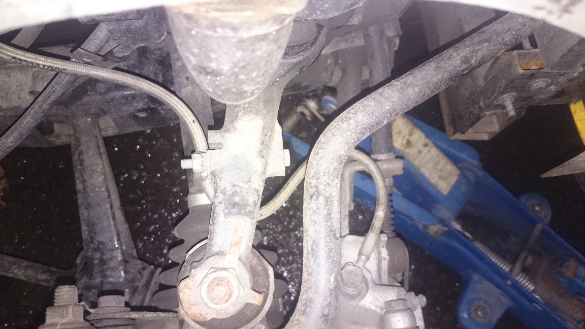

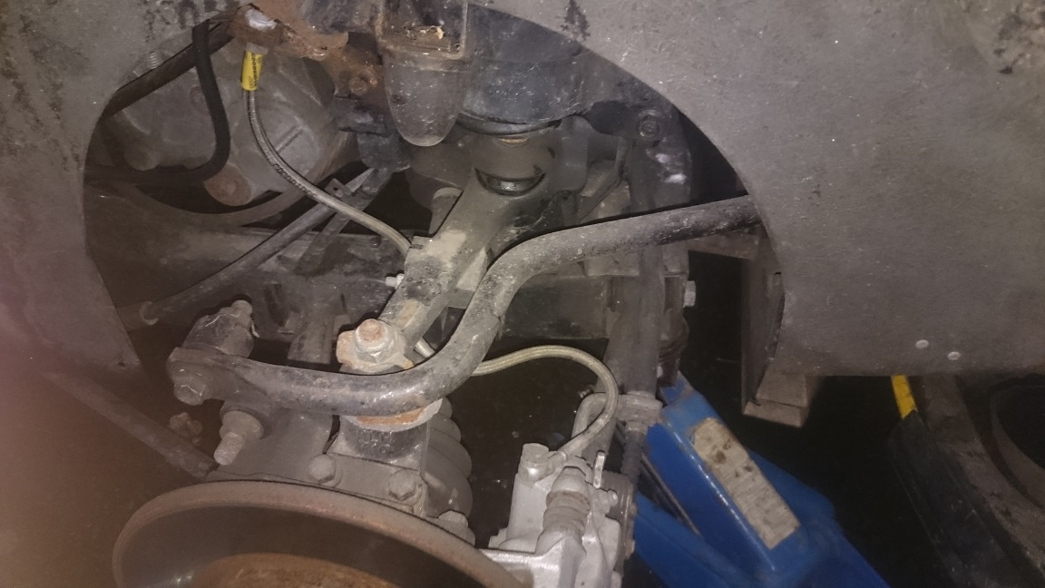

After buying the shocks and all the parts required to fit them, I finally got round to fully checking each corner for clashes today! (I had given a quick glace over it before) Front appears to be fine with minor modifications to heater blower and a minor movement of the washer bottle, but on the rear it looks like I'm going to have to remove my rear anti-roll bar to fit the coil-overs (currently no roll bar on the front), it's not a huge issue as I can fit some with an arrangement similar to http://www.gtmdrivers.com/forum/k3-anti-roll-bars-t3463.html should I decide the car needs them, but until I've driven it it's hard to tell!

I currently have the same setup as you (MGF rear subframe, suspension and anti roll bar) but I can't see how you'd fit the roll bar around the shock as it pretty much passes through the same points.
I'll have another look tonight/tomorrow but it's going to be very close even if I can move the ARB back by 15mm (the max the rim will allow)
