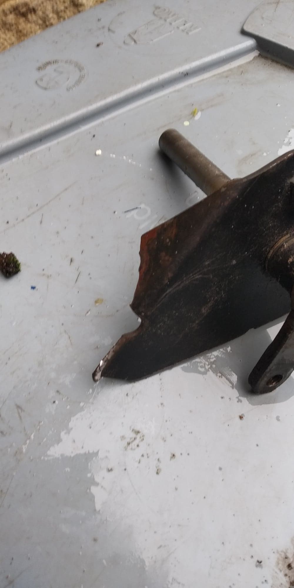

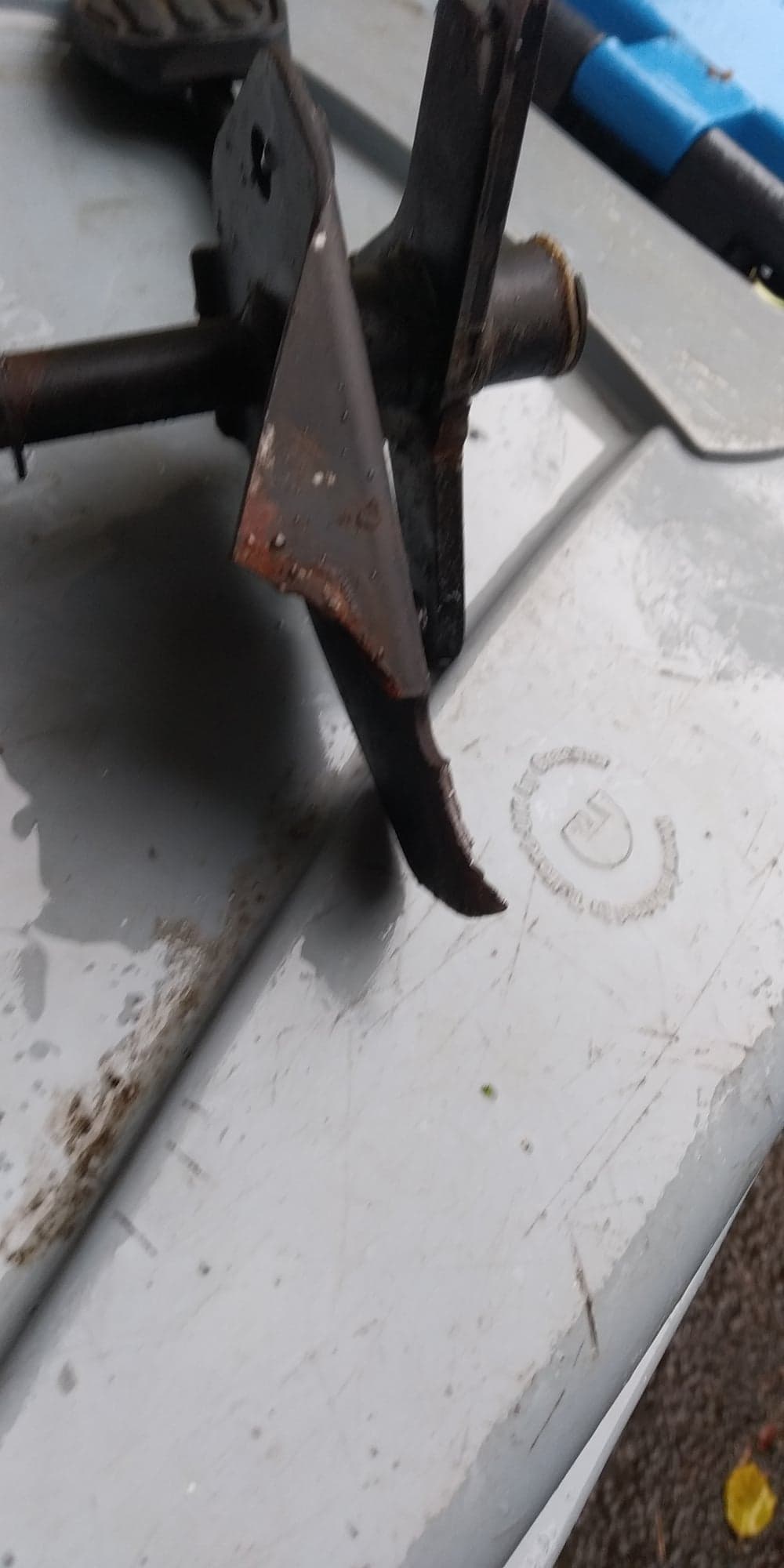

Hi all, just wanted to do a warning message to all with K3s with the modified metro pedal box. Mine just failed on me rendering me without brakes or clutch.
Mines a factory built car so probably a few similar cars out there so worth a check if it looks a bit thin!
Pictures to follow!

Photos below - seems to have failed at the bolt hole and spread from there - was only attached with one bolt in my on that side which is also a bit concerning!
Been around the rest of the car with a VERY fine comb looking for similar issues and found a couple of other 2 bolts where 6 would be better scenarios which are now also rectified!
