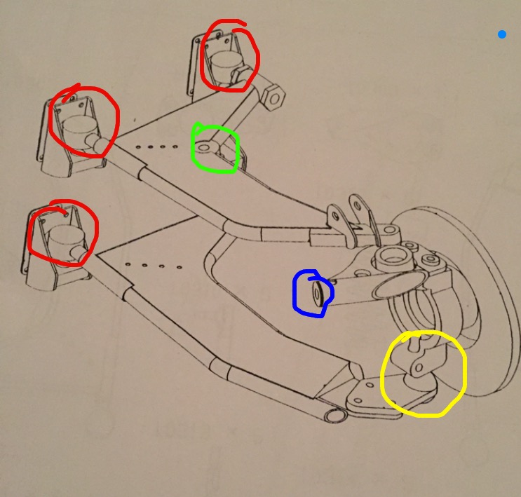

Hello! Absolutely love my recent purchase of a Libra- but she's an MOT failure especially ball joints, so thought I'd try summarise everything before purchasing the bits. Would really appreciate any help. It's Mk1 rear suspension I believe (Not Z car etc), so has the eight ball joints arrangement at the bulkhead, shown in the attached pic (hope it works).
So, as circled in the picture:
RED= Land Rover, part number SS356 x8
(Shown as No. T0307 on the original GTM build drawings).
GREEN/BLUE track rod ends = Metro Part No. SS818 x1 (T0310 on build drawings).
And Peugeot = SS451 x1 (T0311 on build drawings). Not sure which one is which??
Finally, yellow I haven't worked out yet- does anyone know where these come from?
Hopefully an easy bolt on, bolt off job but any advice appreciated- as the rear suspension arms seem impossible to replace I think I'll be removing them, repowder coating and so replacing all the joints whilst I'm at it.
Any upgrade ideas always appreciated.
Many thanks, Jim.
