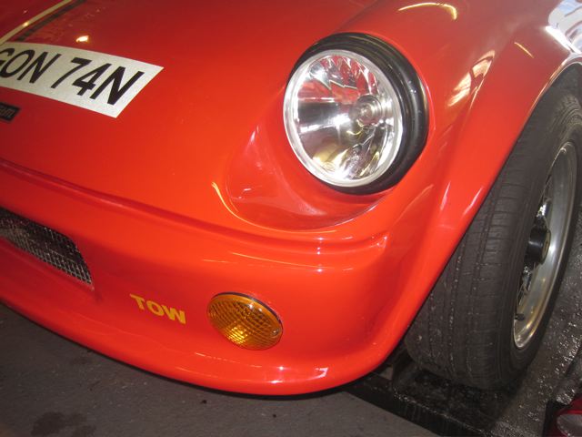

Hi just thought I would chip in with the light mods I carried out on my coupe.
The rears have had the old holes glassed over then a new shape formed to suit the round light
The front indicators have had a tunnel glassed in so they sit flat and dont have that "afterthought" look
Good luck with yours

Post Re: front indicators
Paul
I Have to say IM liking the rear treatment. The bumper trim is a nice alternative.
