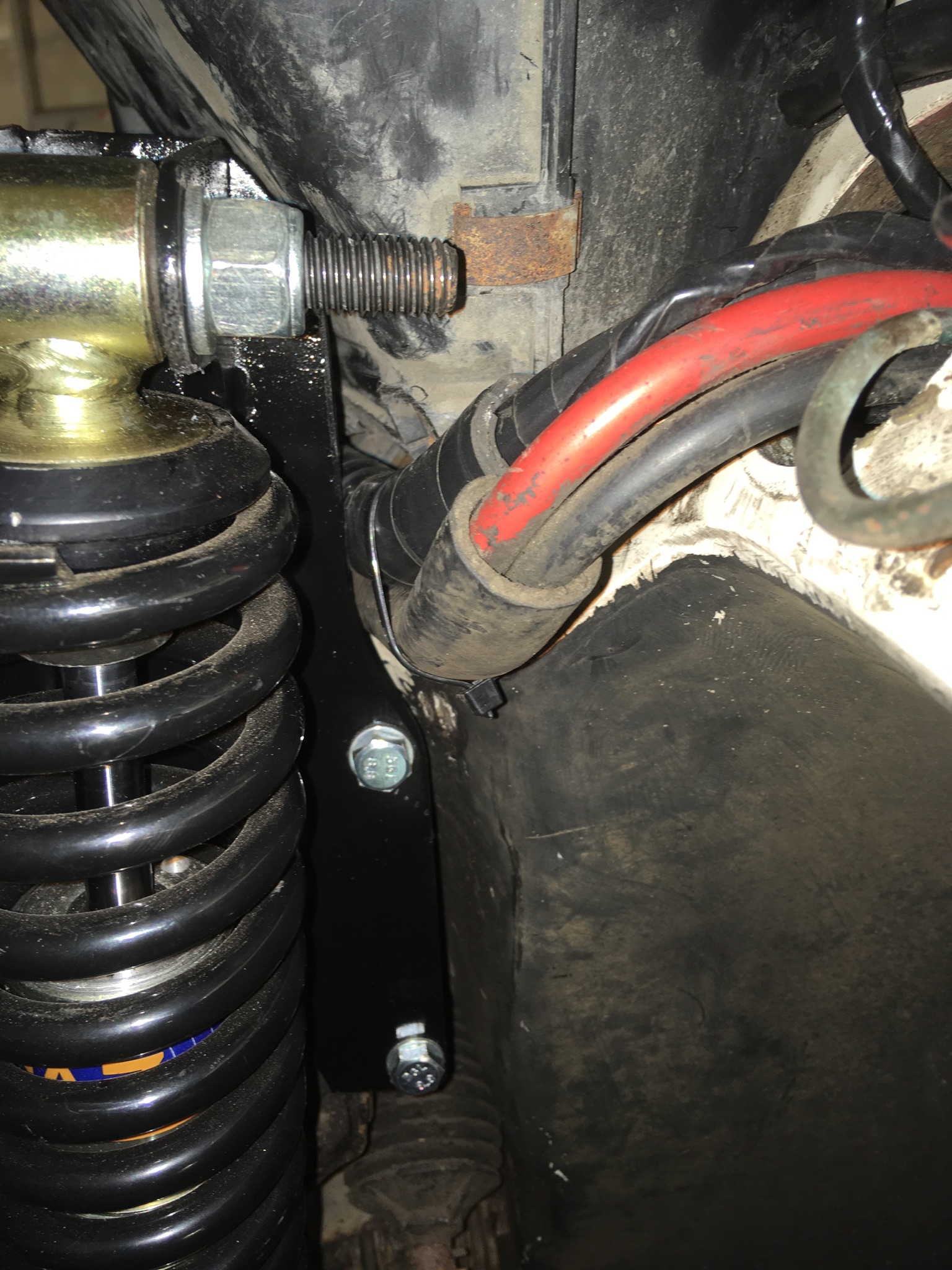

Haven't done anything about the springs yet. However the wiring needed tidying up so decided to get on with that instead. The coilover bracket on the passenger side front touches the heater box even after trimming the casing right back so some metal had to be taken off the bracket to allow the cables to pass through.

I could have just dragged the cables over the top of the coilover but it would look a mess. There's no issue on the drivers side as there's nothing on the bulkhead there. The inner wheel arches need cutting back some to clear the top mounting bush too. On the plus side all the lights work as does the heater and wipers and the dashboard. I finally got the fuel gauge hooked up and found the tank is nearly full! It might be a bit stale now so I'll take out a gallon at a time and bung it in my Suzuki as its too dear to waste :!: I really would like to get rid of the Metro fuel tank but that's a job for next year.
