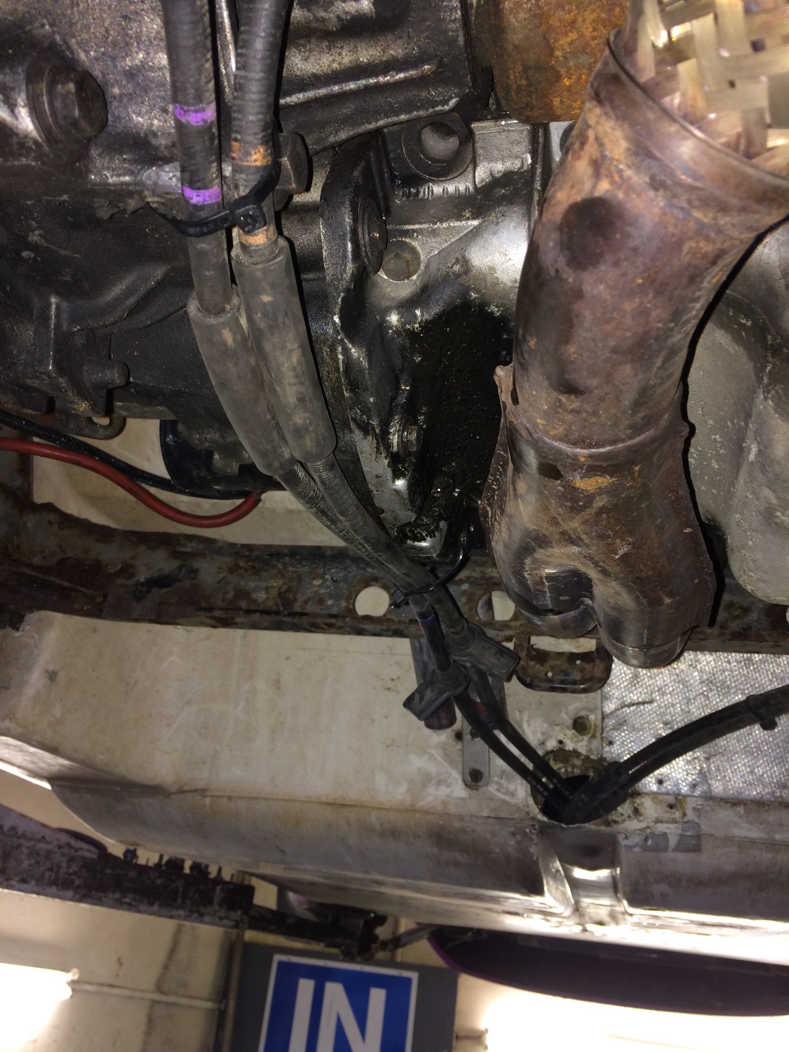

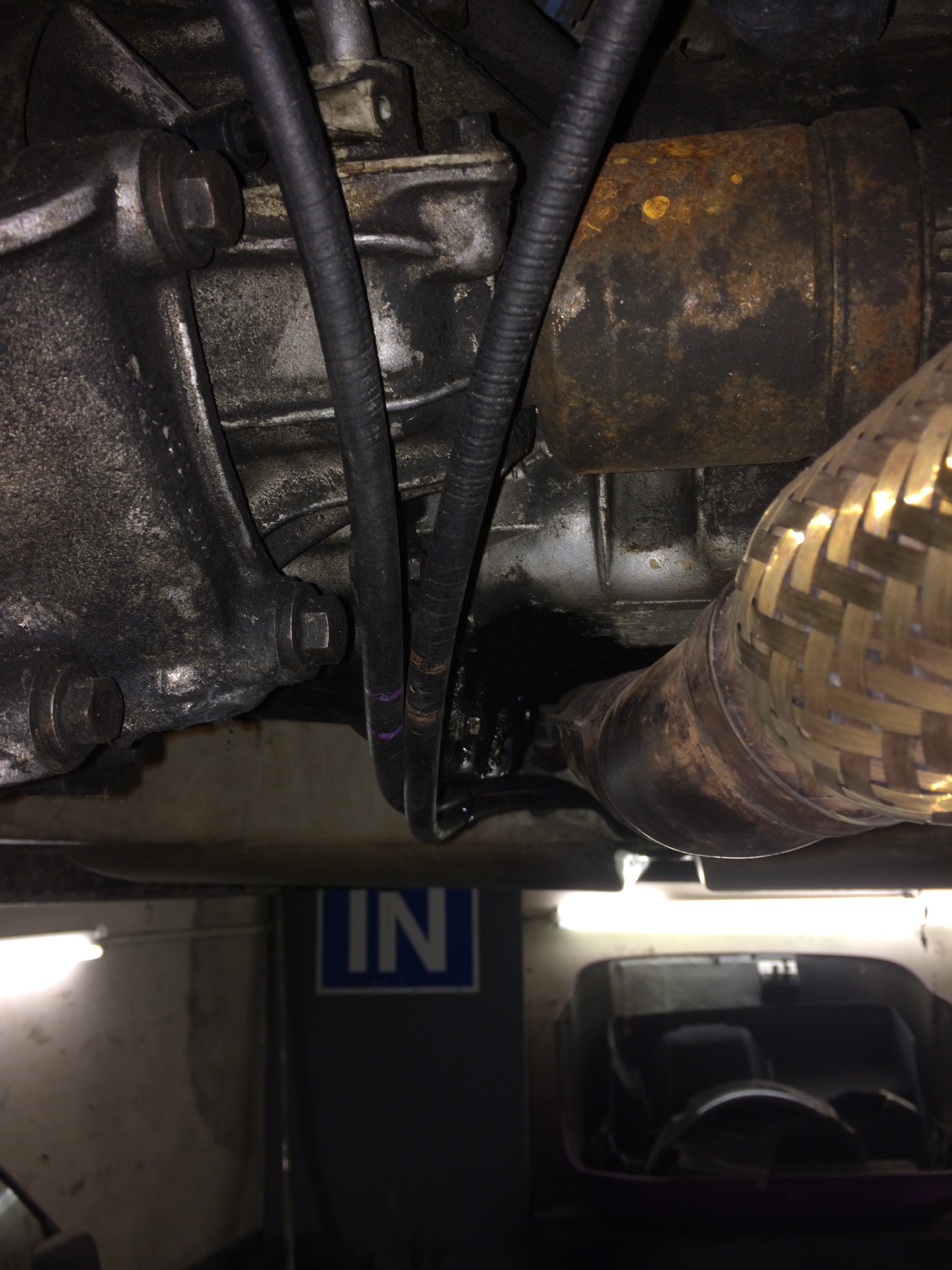

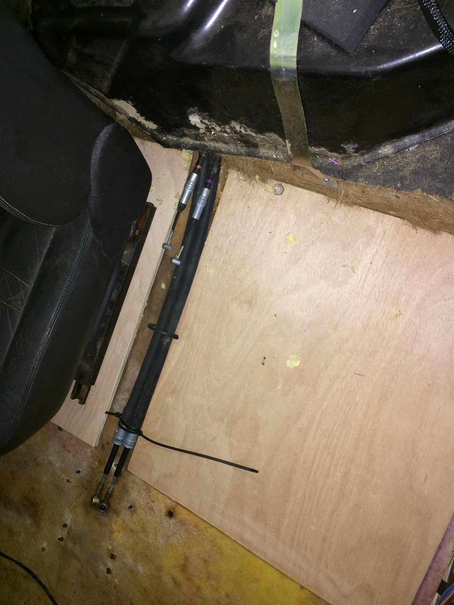

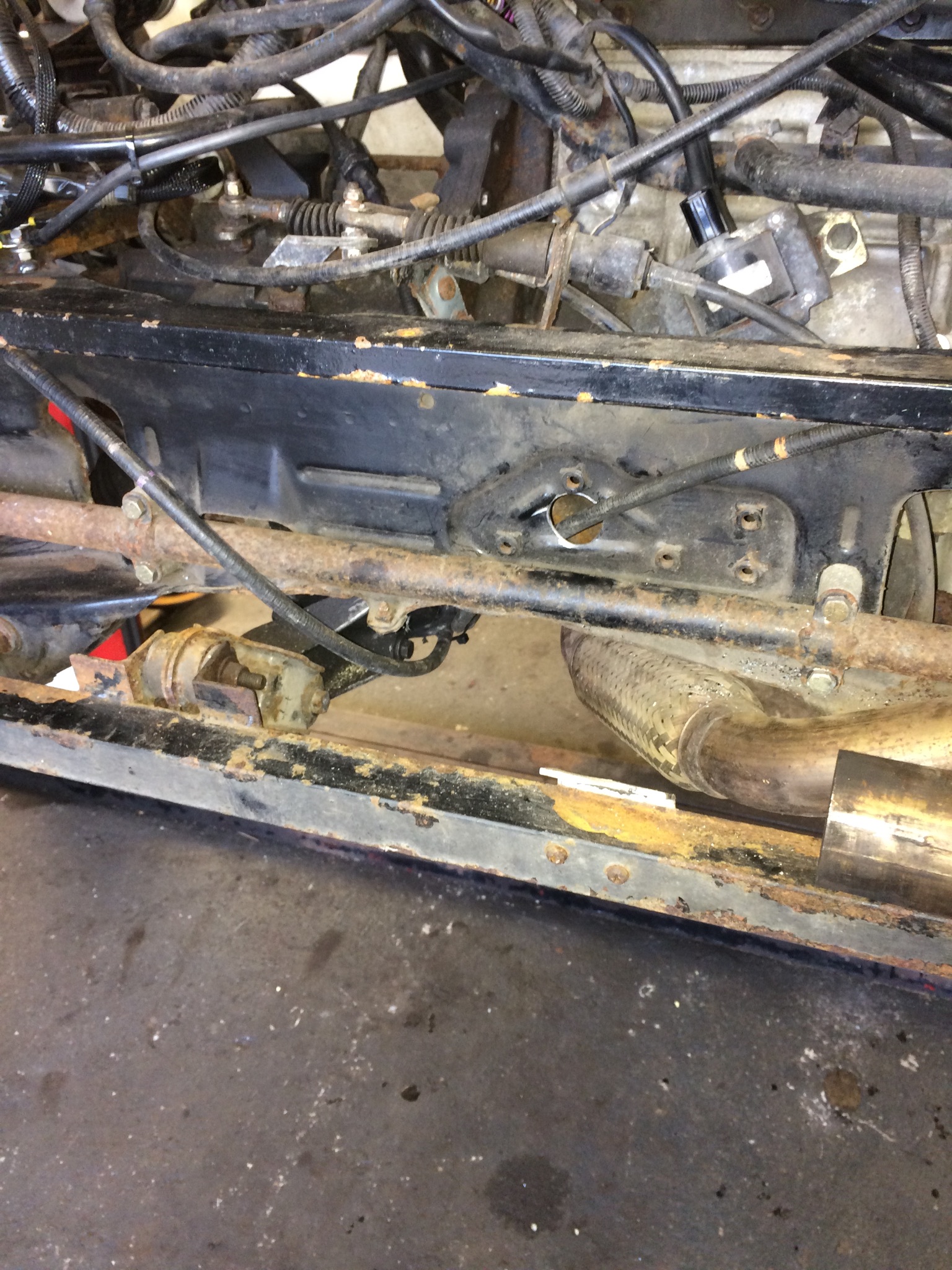

The MGF handbrake cables have been routed under the subframe and into the tub with the gearbox cables. I've sent the right hand cable through a hole on the subframe to keep it off the exhaust. I'll make some brackets or a heat shield maybe to go underneath and keep the cables in place.

Passing that cable through the subframe just doesn't look right in my opinion, think I'd be tempted to pass it underneath & make a bracket to keep it away from the exhaust. Is that the anti-roll bar that can seen in the image, are you leaving it on? No experience of a K3 but I removed it from the buggy as I felt it wasn't needed.

Phaeton, I've put another hole in the rear subframe in line with the one in the pic but a few inches to the left to take the other cable. I've moved the rubber sleeves further up the cables to they are now half in and half out of the holes and the cables now take a smooth and easy route into the tub. Running them outside and under the subframe takes up too much cable length. I do have some more pics but I don't want to put them on just yet. There's no anti roll bar fitted.

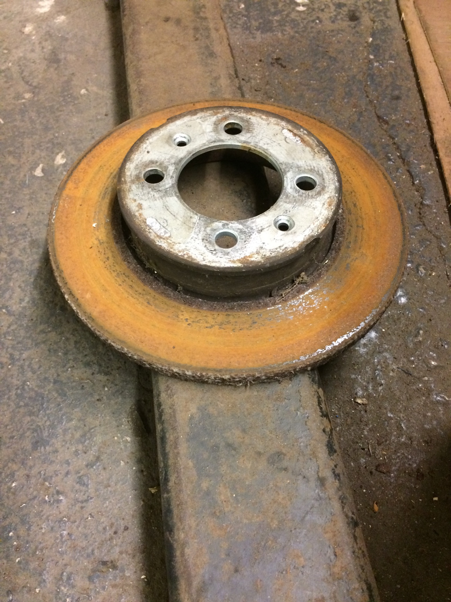

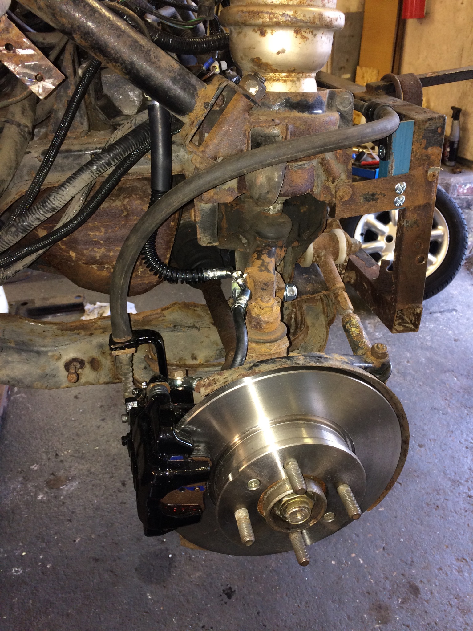

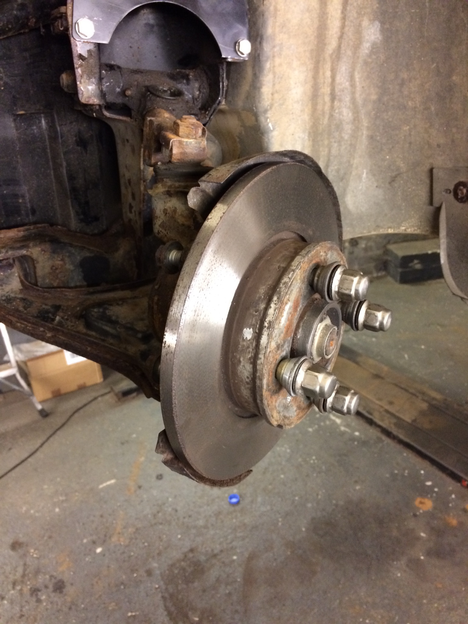

Back end is more or less done so I've started on the front end. Calipers off for cleaning and painting and I've skimmed the discs.
File comment: Rusty old disc before skimming.
File comment: Nice clean disc.

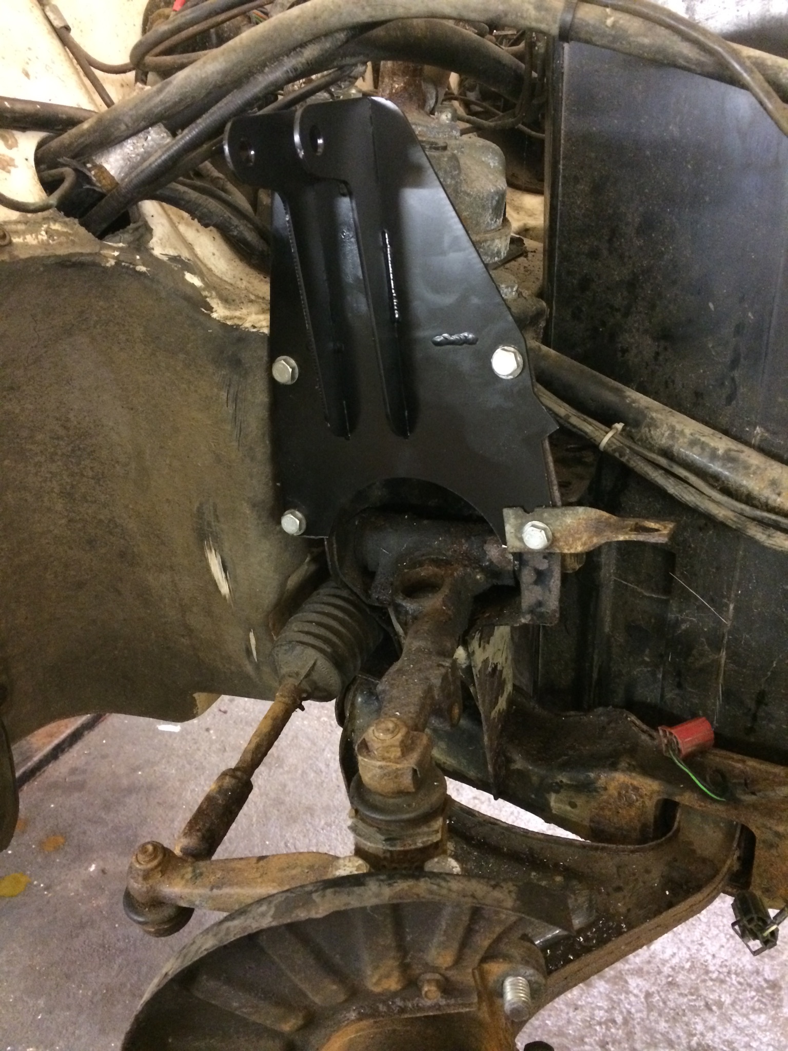

I've also removed all the old hydragas system and fitted the coilover brackets to the front.

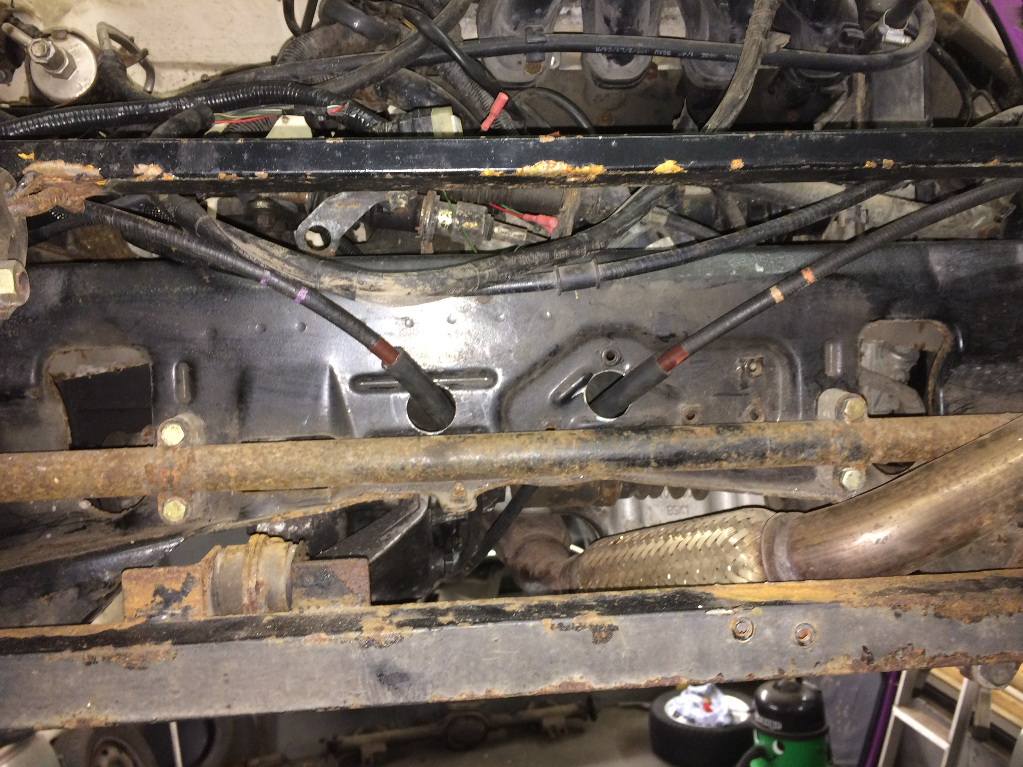

A couple of pics showing the handbrake cables running through the subframe clear of the exhaust. I've made a bracket which bolts to the clutch housing and keeps the cables away from the downpipe.
