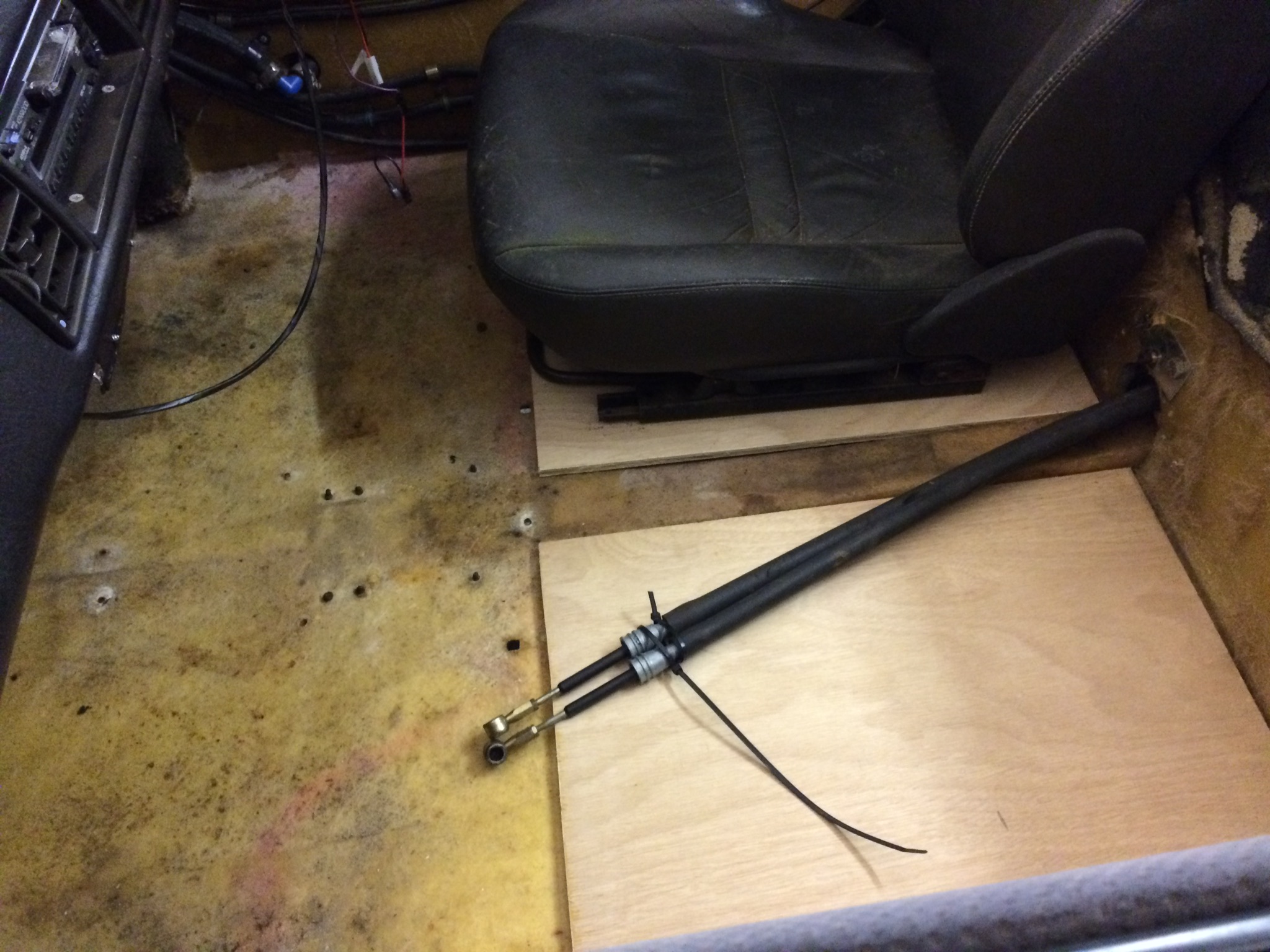

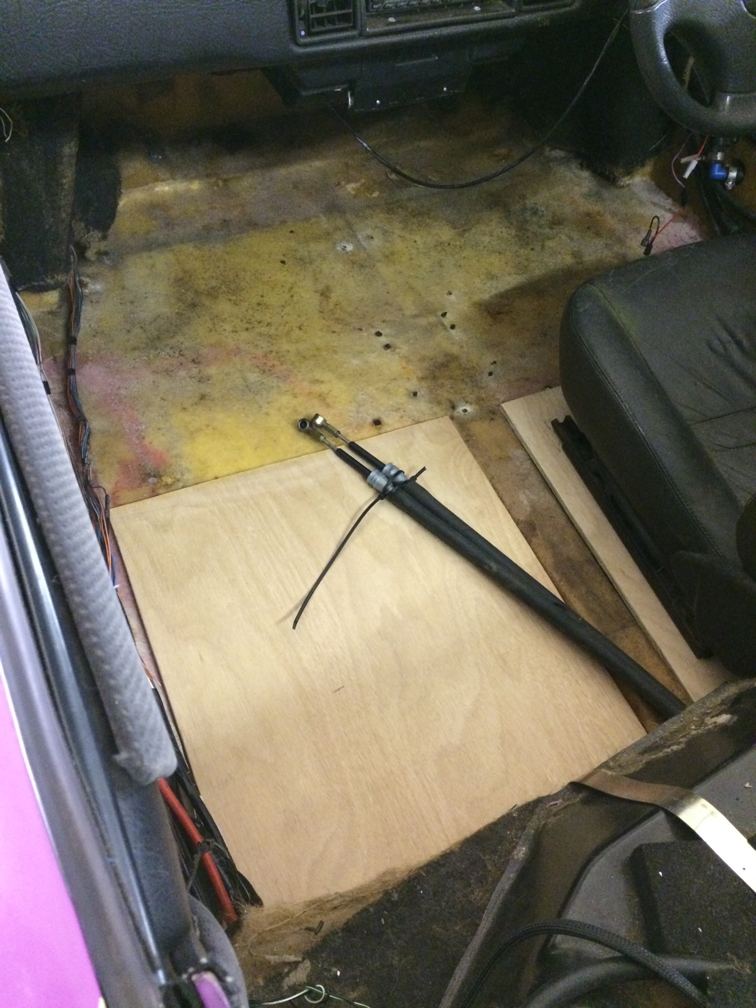

How odd Neil. I can post again now you've split the thread. I'll take the opportunity to post a couple of pics of the floorpan. The idea is to bond three pieces of 12mm plywood onto the floor as i think it needs beefing up a bit.

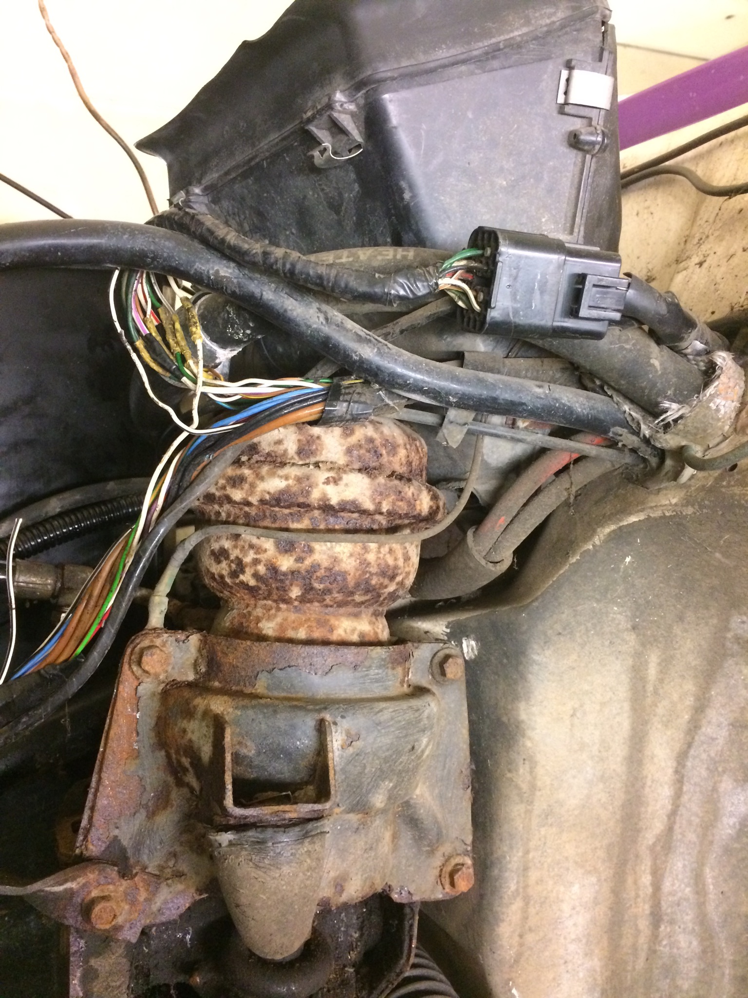

Badly corroded hydragas unit.

They are but the internals could still be very good.

Yes the internals may be fine but I fear the casing may puncture any time soon. I'm also wondering if the poor state of these might affect the car passing its mot. I do have two spare hydragas units that came with the car presumably to replace these but having decided to go with coilovers means I'll be removing the hydragas system completely pretty soon anyway.

Should have no effect on MOT, I like the hydragas system, individualise each sphere & then you can control the height very easily, gives a better ride than a friend with TF springs at the rear.

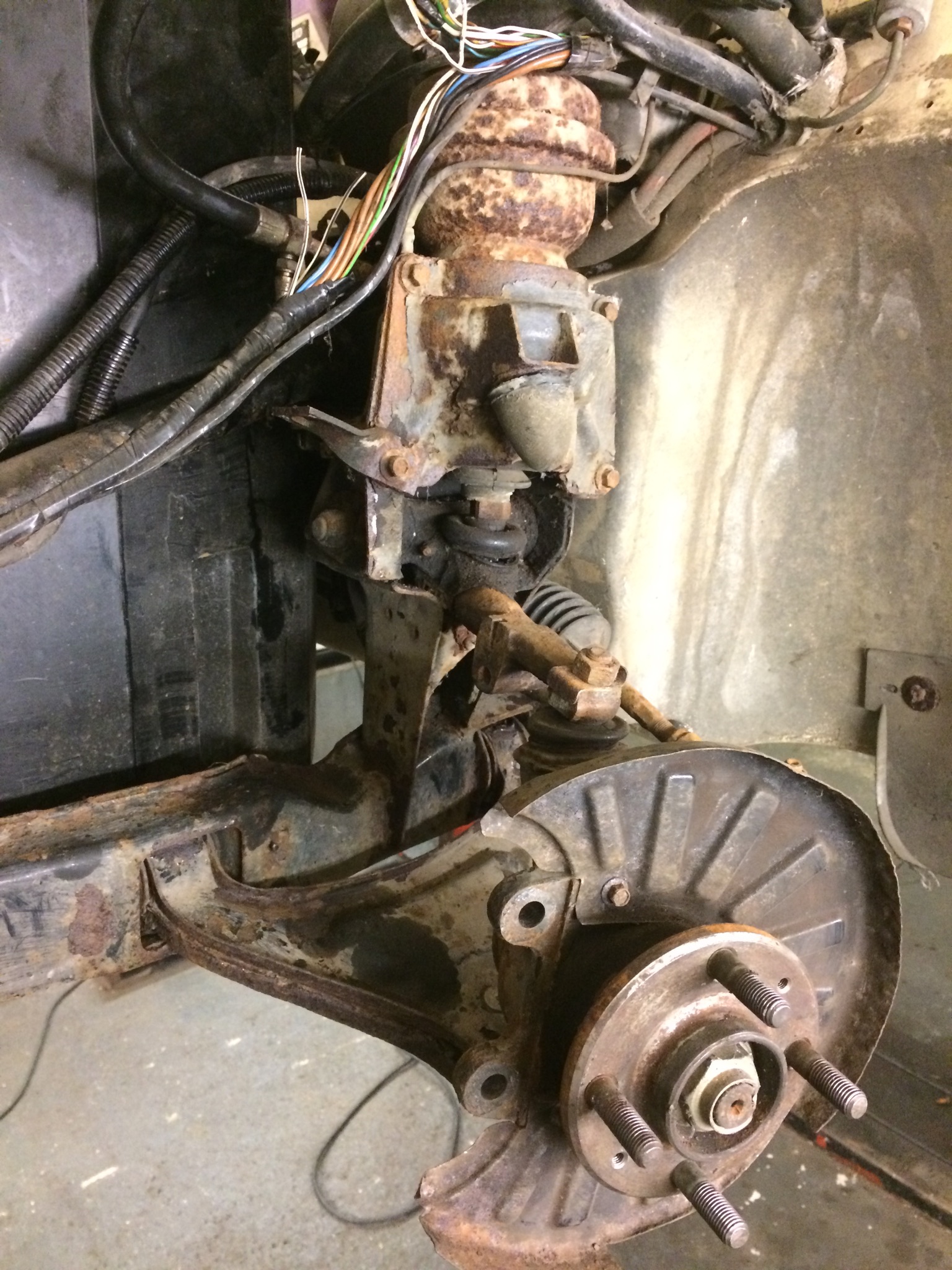

Near side front hydragas unit showing the spacer to alter the ride height. Is that it Steve, that nut I can see just above the dust cover?

Confession time. A chap called Darren from a garage in Ilchester was the mechanic who did the serious work on the car, but I am pretty sure that the necessary 'spacer' (looking very much like any old nut) was 9mm; he did claim that it wasn't likely to fall out which does look to be the case! Haven't used him since the K3 was stored as have a really good garage in Shepton for the sensible car.
Darren's spacer fix was very successful in giving a good front/back ride height at a functioning Hydragas pressure, but it still benefited from an annual pump up. The ride quality on the 60 profile tyres with the pressure up to spec. was on a par with my trusty 306 and that can't be a bad thing!
