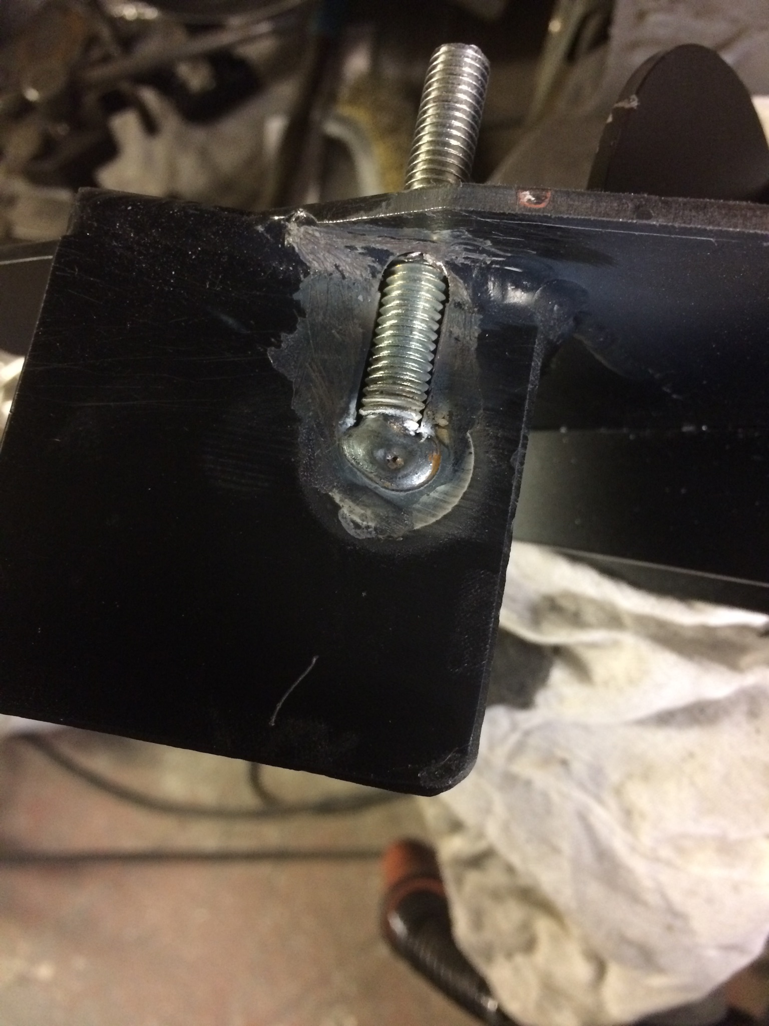

The rear coilover brackets arrived on Friday so yesterday I set about getting them on the car. One thing I noticed is that the top right bolt hole is missing. This is because the fabricated location for the subframe support bar covers the bolt hole. There's a lot going on with this bracket and I didn't feel happy not having a fixing at this corner. I don't know what others do but I even considered welding the bracket to the subframe. Anyhow I decided to drill out the pilot hole that's already in the bracket and drill down the side of the support bar mounting block and weld a stud in.
