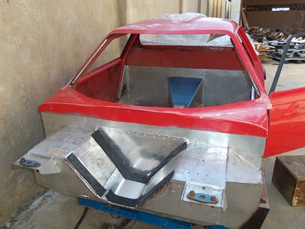

I now have an old Cox style vee in the front of my chassis, still testing local welders to see if anyone can weld an aluminium tank for me, or I have to get it made in the UK and carry back :( I have also chopped out the flat floor panels and am replacing with 1.5mm aluminium sheet, wish I had an air pop rivet gun :roll:
The list of jobs gets bigger before it will get smaller :lol:
