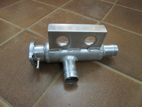

I arrived back to Kano with a large carton with my Ali tank inside, not heavy but awkward to carry :oops:
Sat Sep 19, 2015 4:42 pm
My Jedi made header tank
Sat Sep 19, 2015 4:43 pm
Tank looks good, what is the capacity of it?
Sat Sep 19, 2015 7:14 pm
Hi Neil, 45lt and I hope to be able to sit the spare in front of it :wink:
Sat Sep 19, 2015 8:54 pm
Plenty big enough
