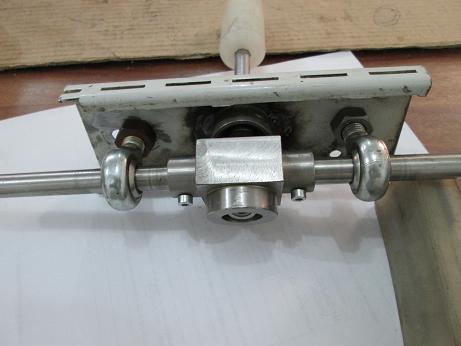

I have been making my new spherical jointed gear lever assembly and a bash plate to go under the gearbox

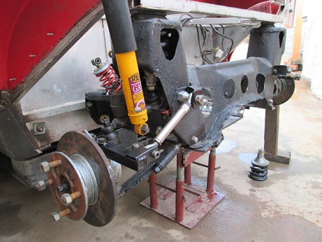

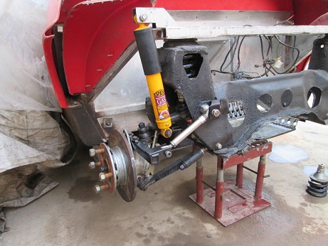

The rear subframe from my twinny Mini has been cleaned up, a new bash plate made, fitted and installed into the back of the GTM, along with new Mini Spares adjustable lower arms and tie rods, MiniTastic “town ride” coil springs and Mini Spares HiLo’s, the hubs and upper arms came out of the twinny but were originally installed in my old Cox with lower A frame suspension.
The drum brake hubs were modified to accept Toyota 1.6 fwd Corolla discs and calipers and the studs are Toyota centers as I wanted to use 13” x 5.5” Toyota steel wheels on the mini, when bush racing you break aluminum wheels if you hit a termite mound, but steels can be straightened with a hammer, I could easily converted them back to mini centers.

My gear lever complete and ready to install
