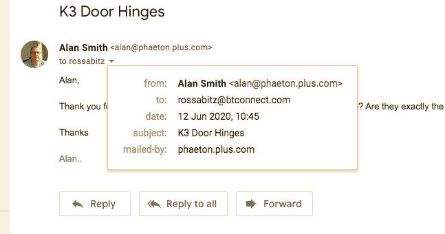

Post Re: Let the Journey Begin
That's weird,

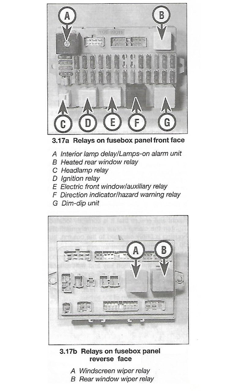

hi no problem unit 382 is on what I call the back of the fuse box the over side to the fuses
A / WINDSCREEN WIPER RELAY
Brilliant, I had that out the other to rehang the drivers door, never noticed a relay, but then again I wasn't looking for one, so it may or may not be there, I also have a MGF harness & box somewhere so that one might be the same if it's missing.

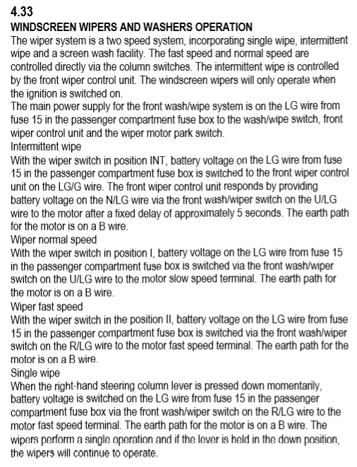

So spend most of this afternoon tracing wires & proving things through, got really frustrated as everything should have logically worked, my wiring is definitely different to yours, it follows these colours, where 30 is the motor, 73 the relay, 49 the switch & 44 the washer
Upshot is, pretty sure it's the stalk that is faulty, I cleaned all the terminals & at different times I had everything working, but only by twisting & turning the stalk as I had it on a setting. Before I take it apart I'll see if I can another one the sequence appears to be from the top
1. Fast
2. Slow
3, Off
4. Intermittent
This what I need if somebody has a box of spares
