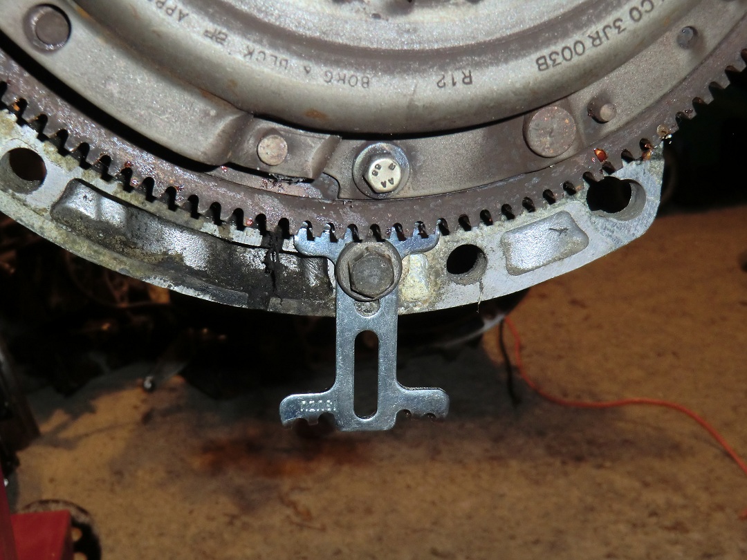

http://www.amazon.co.uk/Draper-71173-Flywheel-Locking-Vauxhall/dp/B00023T9LG
I tried one of these for locking my flywheel. Its meant for Vauxhall/Izuzu but at £1.36 delivered thought it was worth a try, even if it needed adapting. As it turns out it just needed a few strokes of a file to get one of the smaller gearbox bolts through the slot and the smaller end fits perfectly into one of the threaded holes towards the bottom of the block when the timing marks are in the service position. Held it fine whilst undoing the pulley bolt that was very tight!

looks like it does the job and cheep
