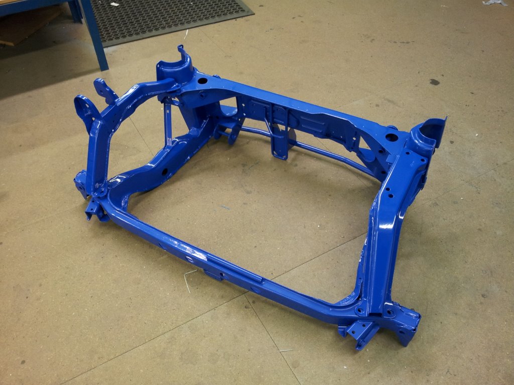

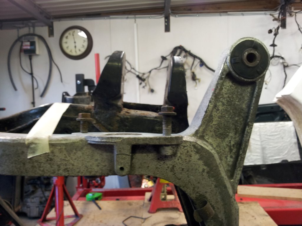

This is the mgf subframe showing the engine and gearbox mounts
The engine and gearbox buttresses
With the gearbox mount
Am I right to understand that the engine mount(alloy cast) will hit the tub??
This is the rover metro subframe showing the engine/ gearbox mounts and buttresses
You have shown modified gearbox buttresses
what do you need to do for the engine mount insted of the alloy one? The metro one

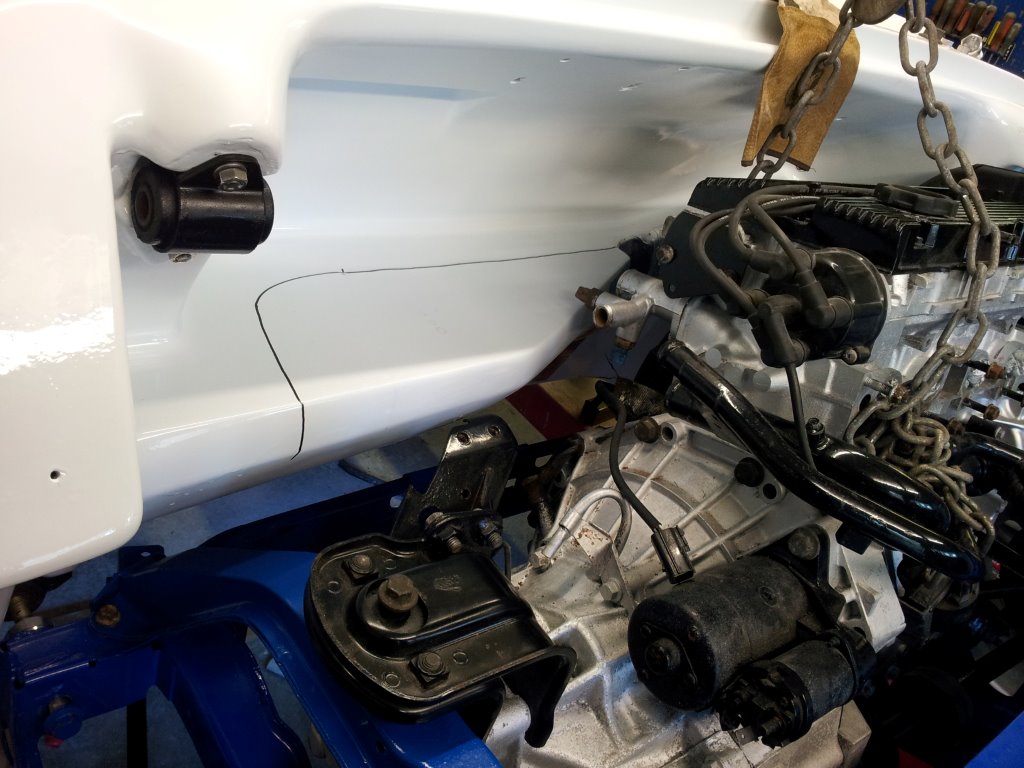

See picture of comparison between the MGF lovely mount arrangement which hits the tub and the original Metro bobbin type mount. Unfortunately this is the only one that fits but the good news is that it bolts off the subframe and fits straight on to the MGF subframe. You will also need to swap the rubber bobbin off the metro engine on to the MGF engine.
And while we are on the subject if you retain the PG1 gearbox and clutch you will need to chop some of the tub away for clearance. Pictures available.

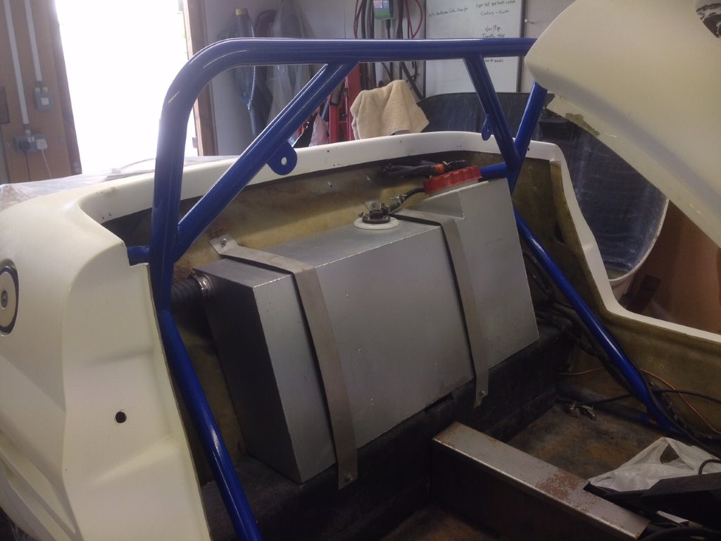

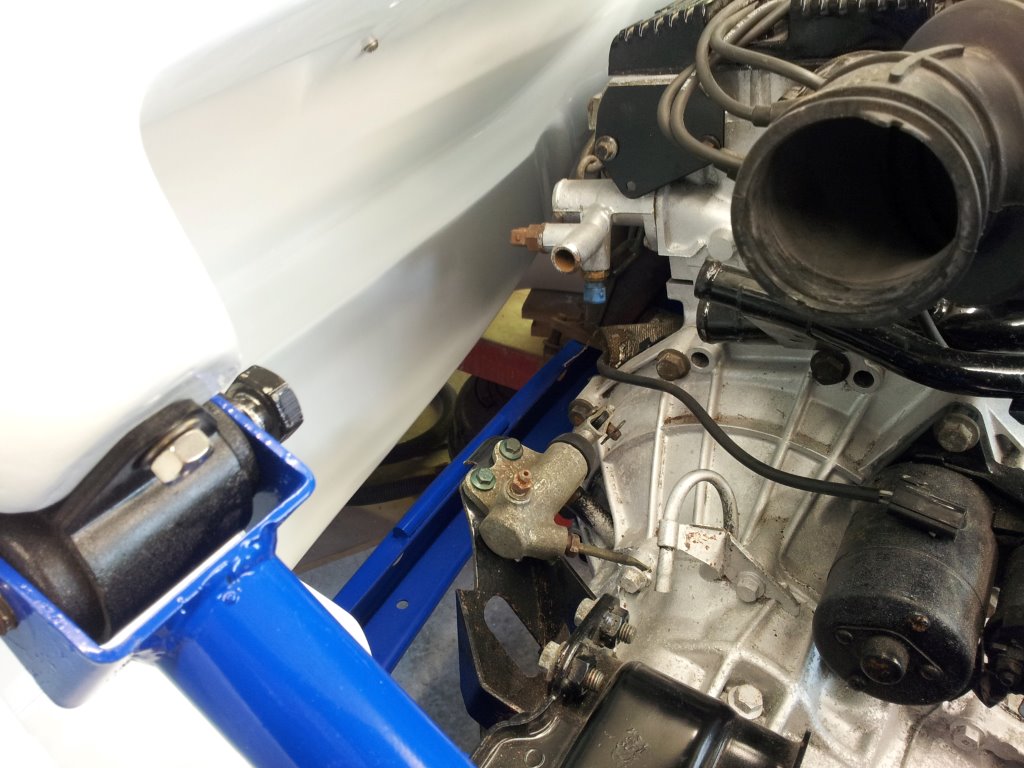

There was two problems, the clutch slave cylinder on the PG1 bracket and also the cylinder head water outlet hoses. I cut out quite a lump to clear both which rendered the fuel tank space compromised so I made another tank to fit behind the seats. See before and after shots.

I have just looked at a spare metro subframe and an mgf subframe. Both are the front ones and are the same. They are only missing the steady bracket and the support bar for the jacking point. That being the case by welding the steady bracket on it should be fine. If you need another subframe you are welcome to one of these.

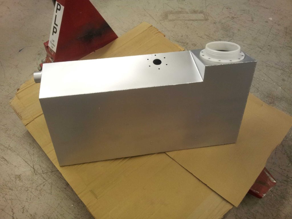

Haha, of course its custom made, its the law! I made it to fit on the shelf behind the seats, see pic. The dimensions are 800mm long x 660mm high and 150 to 180mm tapering from bottom to top. It looks as if the Elise tank may well fit and if so i will be Miffed.
Peter

so this is yours
32" long x 27"high 6" to 7 1/2" tapering
in inches as the elese tank is in inches.

Your before you cut the bulkhead picture above , would you say the engine was in the correct position??
Just no clearance for the hose and slave cylinder?
Did you still modify the gearbox buttress as described above?
The owner isn't
Wed Sep 02, 2015 3:22 pm
Post Re: Paul's k3
In the before picture the engine was mounted on the modified gearbox buttress but if you zoom in to the bottom left of the picture you will see that the complete subframe was about 30mm away from final position. Notice the 15mm spacer on the bolt that goes through the mounting. These were left on permanently.

I see what you mean.
I was thinking about some alternitves:
Mod the clutch slave mount so it doesnt stick out towards the bulkhead, may be rotate the slave 90 degrees and mod the bracket.
Change the water outlet to an elbow something like the rover 800 one or landrovers outlet , so it elbows immediately out of the head
The other idea I had was to lean the engine a little away from the bulkhead, this could be done by using an adjustable bottop support
The owner isn't
Thu Sep 03, 2015 1:42 am
Post Re: Paul's k3
on my car, the water hose is above the bulkhead and the hose runs along with it I would think that this would be the same with the 1.8vvc engine when it's in the car
I like the idea of changing the clutch slave mount. if you could get this to fit you would then not have to cut the bulkhead but this sounds like it is to easy.
