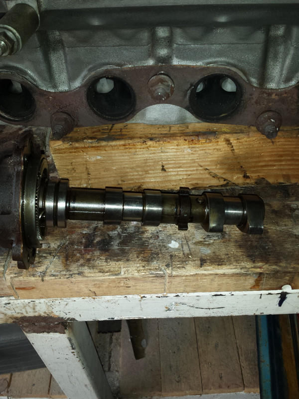

I have taken the engine apart.
at some point, I think the head has been taken off there was still old inlet gasket stuck on the inlet manifold
and I found the head gasket was no good
and there is some damage to the inlet cam
but the head does look like it is OK
the problem with the cam
it looks like when the head bolt was taken out off the head the reluctor was in the way of the bolt.
the head bolt has taken off the corner of the CMP relutor
I still get a signal from CMP when you rotate the cam by hand but I don't know what will happen when it runs at 3000 rpm.
will it still see the signal or should I change it

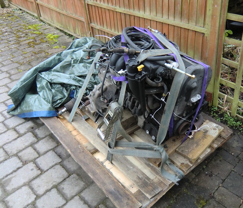

You've got a lot further than me. Mine is still on the pallet!
Wed Jul 01, 2015 8:02 pm
Post Re: Paul's k3
But it is the fastest pallet around :!: :lol:

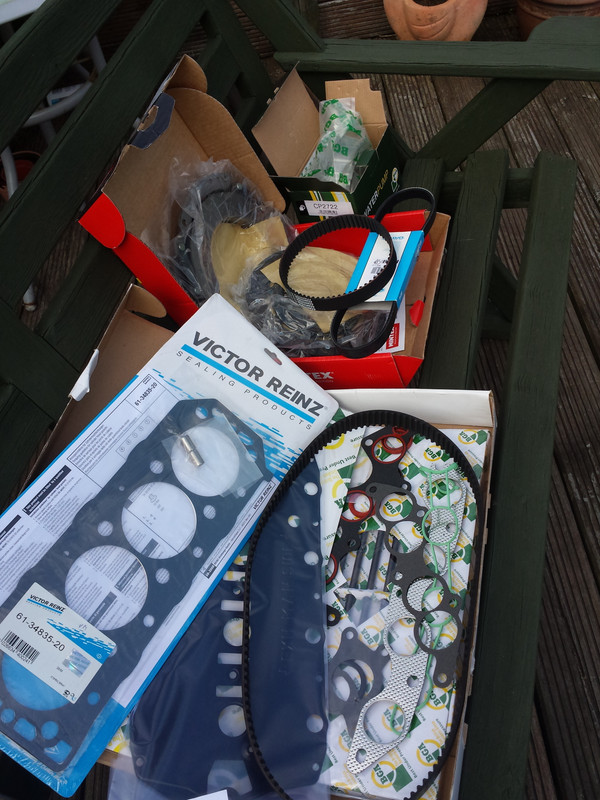

not much has been done on the new engine swap but
I have got lots of new parts :D
and I have a new cam from eBay for my engine this should be fun to fit :roll:

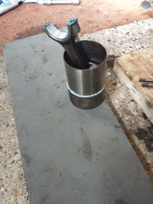

I have also found that the liners are loose and I will need to reseal them as the engine is in parts.
:?: can this be done without taking the sump off

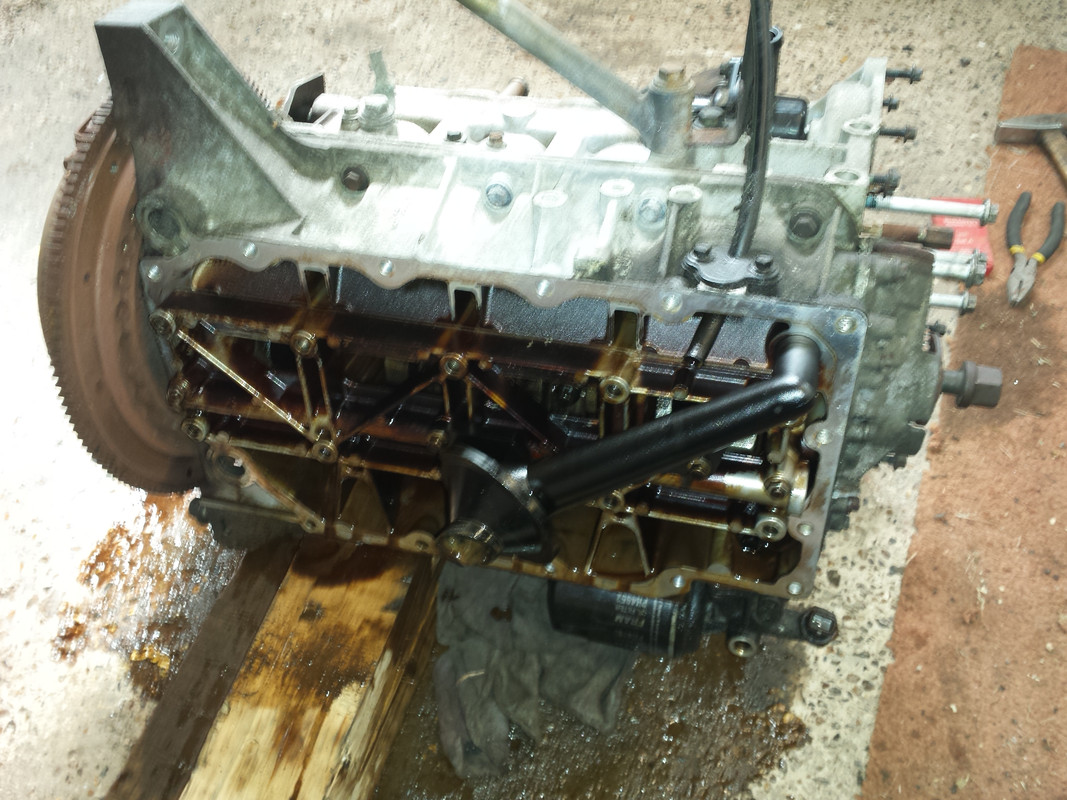

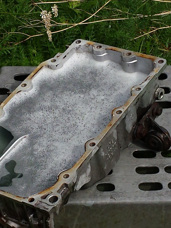

I had a bit of time this weekend and have taken the sump off.
the oil looks a bit like Mayonnaise it's a good job I had to take the sump off because the liners are loose and will need to be resealed
I gave the sump a wash with some degreaser.
all I have to do is find the right Flange Sealant.
so I can put the sump back on.
there are so many Flange Sealants,s out there which one to use
I have pulled all the liners out and they all look ok.
They just need a clean and add some Sealant then I can put all the parts back
the liners were taken out and re-sealed

Is that a home made flywheel locking tool in the 2nd from last pic? I could do with one of those soon. Could you post a pdf of the shape of it please!
Mon Aug 31, 2015 2:09 pm
Post Re: Paul's k3
hi yes, that is a homemade flywheel locking tool in the 2nd from the last pic?
I could do with one of those soon. Could you post a pdf of the shape of it, please!
I do not have a pdf of the shape I made it by using some cardboard and some scrap steel, not all that CAD more cad (cardboard aided design ) I cut the gear part with a hacksaw.
it did not look all that good but it did work
