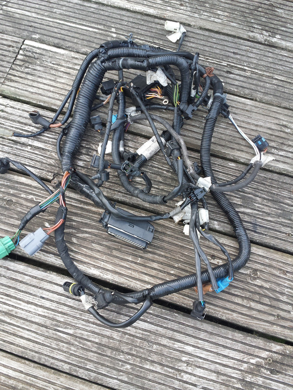

I have started to do some work on the wiring loom. I have got an MGF MEMS 3 COMPLETE FULL BODY WIRING LOOM
All I have to do is find out what wires I need to run the engine and all the instruments
This should be fun
Two days and a lot of looking at diagrams, and I got it down to this
Image Image
I have taken the engine loom off the engine (the right photo). You can see the matching green and grey plug; the big ECU plug is on the engine loom, and the small ECU plug is on what's left of the MGF loom. The plugs for the relay module / Inertia Fuel Cut-Off Switch / Ambient Air Temperature (AAT) Sensor
/ plug for Engine Bay Cooling Fan
Also, on the MGF part, there is a plug for the rough road sensor
cars without ABS, there is a reluctor ring and an ABS sensor fitted to one hub. MEMS 3 cars have a misfire detection facility which is part
of the On-Board Diagnostics (OBD) system. Misfire
detection is disabled when the ECM senses that the
vehicle is on a 'rough road'. The system software
can detect variations in the signal output and disable
misfire detection to prevent incorrect faults being
logged by the ECM.

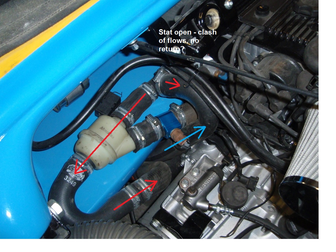

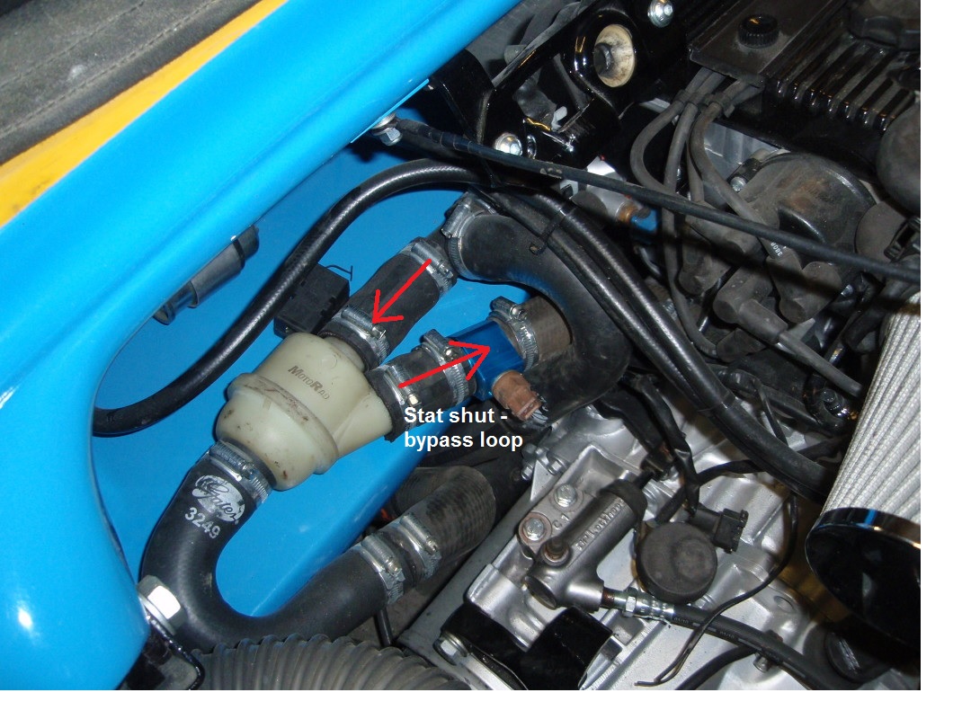

I'm trying to make sense of that PRT set-up. It might be me being thick (or addled by the cold virus) but it seems to me that there is no route for the cooled water from the radiator to get back to the water pump inlet?
When the stat is closed the water will come out of the head outlet, flow as far as the closed stat and then come back up the sharp angle into the bypass and go back to the water pump (via the presumably removed original stat location). Presumably nothing can flow towards the radiator via the tee before the stat because the stat is shut thus its a closed circuit.
When the stat opens the hot water will tend to take the path of least resistance which is presumably straight on through the PRT body and head off towards the rad. If it does this it will come back to that tee piece near the head outlet and meet hot water coming the other way?
Alternatively, if it would rather flow via the tee piece towards the rad (maybe due to the stat restricting the flow making the other direction seem preferable, then the cooled water coming back from the rad would pass over the stat and make it close again?
Shouldn't the return flow go back to the water pump, not back to the stat? I'm confused because I've seen pics of other installations that look like this and I can't see how they work.
