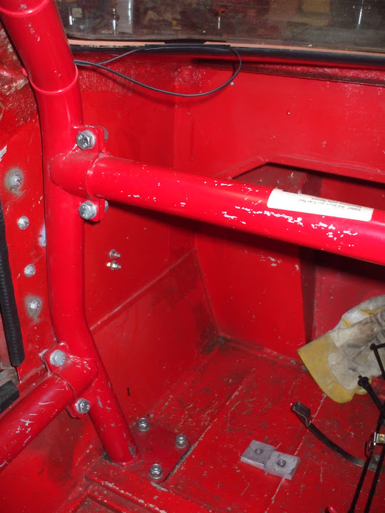

Post Re: Rollcage
Before ordering a PPC cage check with your local MSA Scrut.
One had a look at my car (David's old one) and commented on the front legs.
He asked about reg 1.3.1 :- https://www.msauk.org/assets/153191comm ... afetyk.pdf
1.3.1. Main, Front and Lateral Rollbars. These frames or hoops must be made in one piece without joints.
Their construction must be smooth and even, without ripples or cracks. The vertical part of the main rollbar
must be as straight as possible and as close as possible to the interior contour of the bodyshell. The
front leg of the front rollbar or a lateral rollbar must be straight, or if it is not possible, must follow the
windscreen pillars and have only one bend unless a windscreen pillar reinforcement [1.3.5(e)] is fitted.
Luck I was able to convince him of the previous heritage of the cage being passed by several others during it's life and it holding a MSA log book.

Post Re: Rollcage
I take it the question was due to the kick in the tube which means it follows the inner sill shape. One way around this would be to build up a tower/base to bring the cage down and onto, Or reinforce the sill area and bring the tube down and miter it into the reinforcement of the sill . From memory Peter Wilcocks car is like this.
Fri Nov 13, 2015 1:55 pm
Post Re: Rollcage
http://www.customcages.co.uk/news-room/msa-rule-changes-and-update-kits
Might be the answer.
But it does say " only one bend in the A pillar tubes below the bottom of the windscreen."
I think the first bend is above this level
and "Note that the section of the front leg immediately above the floor mounting need not be vertical but the mounting is not to be readward of the forward most point of the ROPS"
As always with the Blue book, there is a lot of judgement by the Scrut.
